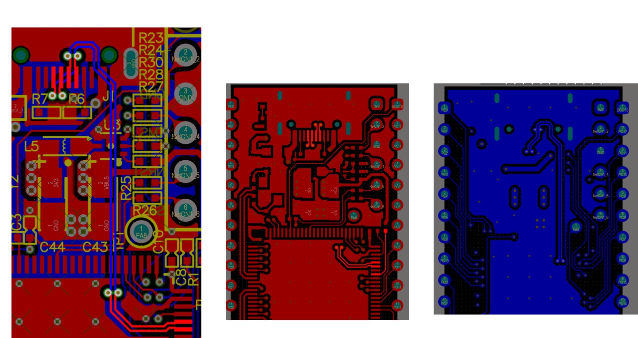

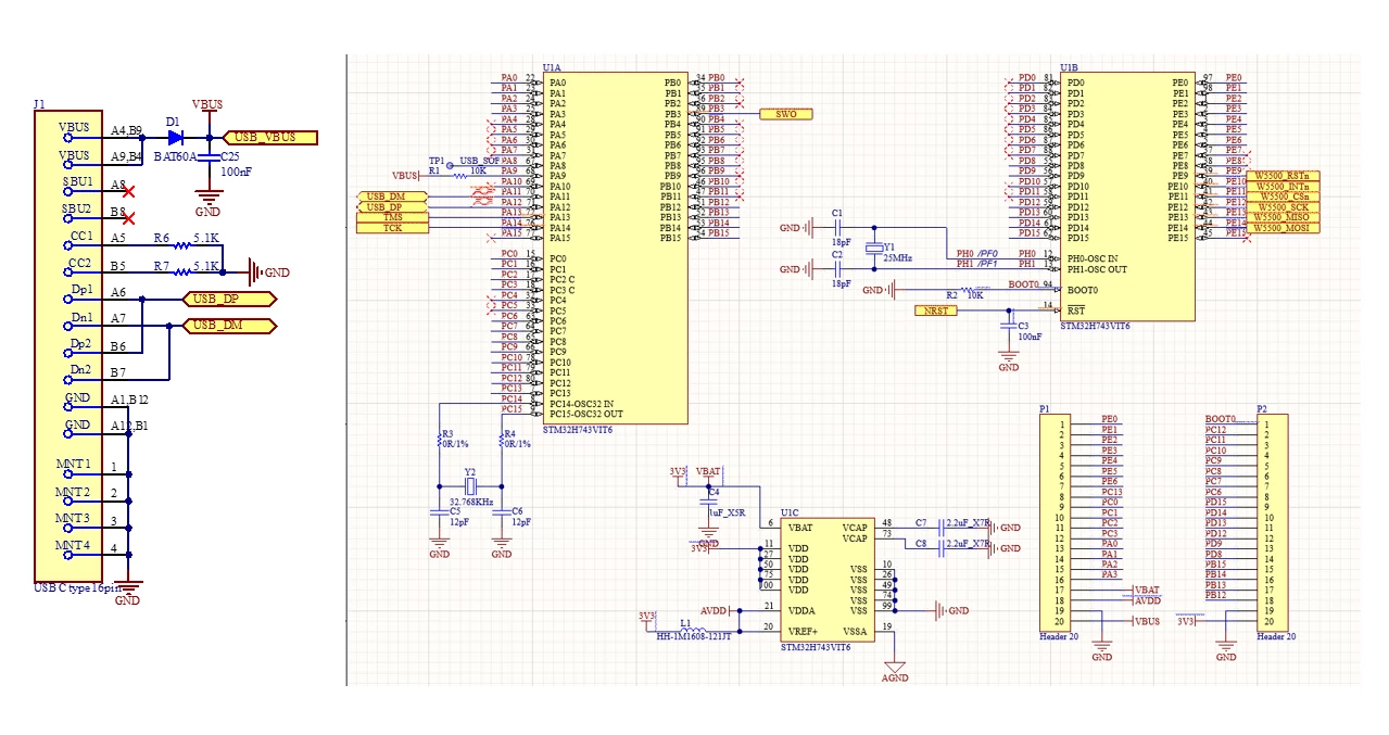

I've designed a board based on the STM32H743 Nucleo board, but unfortunately, I'm facing difficulties with the USB functionality. I'm unsure if it's a matter of configuration or firmware. When I tested USB settings and functionality using the Nucleo board, everything worked seamlessly. Therefore, I'm inclined to think that the issue might lie with my board's circuit design.

I've confirmed that the issue was caused by not changing the setting from 144 pins to 100 pins. It's working fine now. Thank you.
