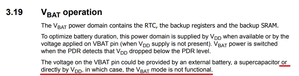

Hello ST Support,
I am using an STM32H743VIT6 on a custom PCB. The PCB has already been fabricated, and I discovered that the VBAT pin is left unconnected (floating).
My application does not use RTC, LSE, backup registers, backup SRAM, or battery backup functionality.
The MCU is continuously powered from 3.3 V through VDD.
I would like to confirm whether leaving VBAT unconnected can affect normal MCU operation while VDD is present, specifically:
  • CPU execution
  • Flash operation
  • GPIO
  • DMA
  • SAI/I²S
  • UART
  • USB
  • interrupts
  • timers
  • normal peripheral operation
I understand from RM0433 that the VBAT domain contains the RTC, backup registers and backup SRAM, and that when VDD is present the backup domain is supplied from VDD.
The reference manual also states that VBAT may be connected directly to VDD, and that VBAT functionality is used when VDD is not present.
My specific question is:
With VDD continuously present and no requirement for RTC/backup functionality, is an STM32H743VIT6 with VBAT left floating guaranteed to operate normally, or can the floating VBAT pin affect any part of normal MCU operation?
The PCB is already fabricated, so I would particularly appreciate knowing whether this requires a hardware rework or whether the board can safely be used for normal operation.
If ST recommends connecting VBAT to VDD even when VDD is always present, please clarify whether this is a mandatory functional requirement or a recommended hardware-design practice.
Thank you.

Gyessine
Sep 2, 2026 8:48 AM UTC
Hello ​@GowthamShakra
The documentation indicates that when VDD is present, the backup domain is normally supplied from VDD, and VBAT is only used when VDD is absent.
The VBAT domain is associated with retaining RTC, backup registers, and backup SRAM during power loss. So if your application uses any of these features and VDD can be turned off, then VBAT should be properly connected to a valid backup supply.
BR
Gyessine

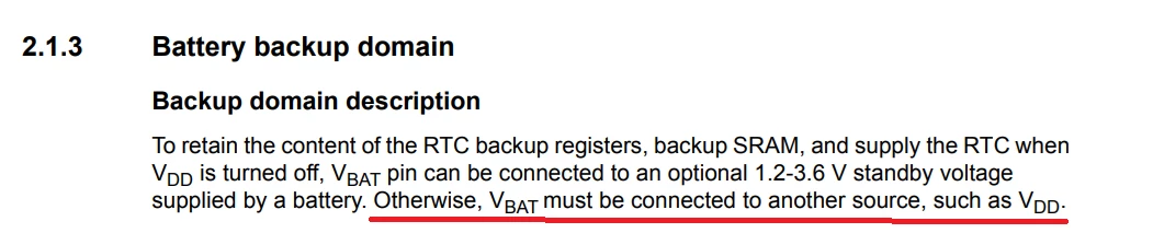

mƎALLEm
Sep 11, 2026 10:52 AM UTC
VBAT left floating guaranteed to operate normally?
No,
If the backup domain is not used, VBAT should not kept floating. That must be connected to any other source such as VDD:
From the datasheet:
From the AN4938 “Getting started with STM32H74xI/G and STM32H75xI/G MCU hardware development”
Hope that answers your question.

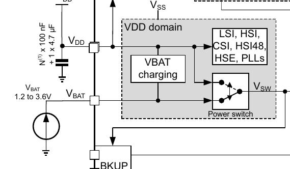

AScha.3
Sep 2, 2026 9:40 AM UTC
>Is VBAT required for normal MCU operation when VDD is always present?
No.
see ds , power connection:
So if VDD is up, the Vbat area is powered by Vsw → VDD anyway. So no problem for the cpu, if Vbat is not powered.
btw
I use the H743 , sometimes a board (with RTC and Vbat battery holder) has no battery - but never a problem for running the cpu.
