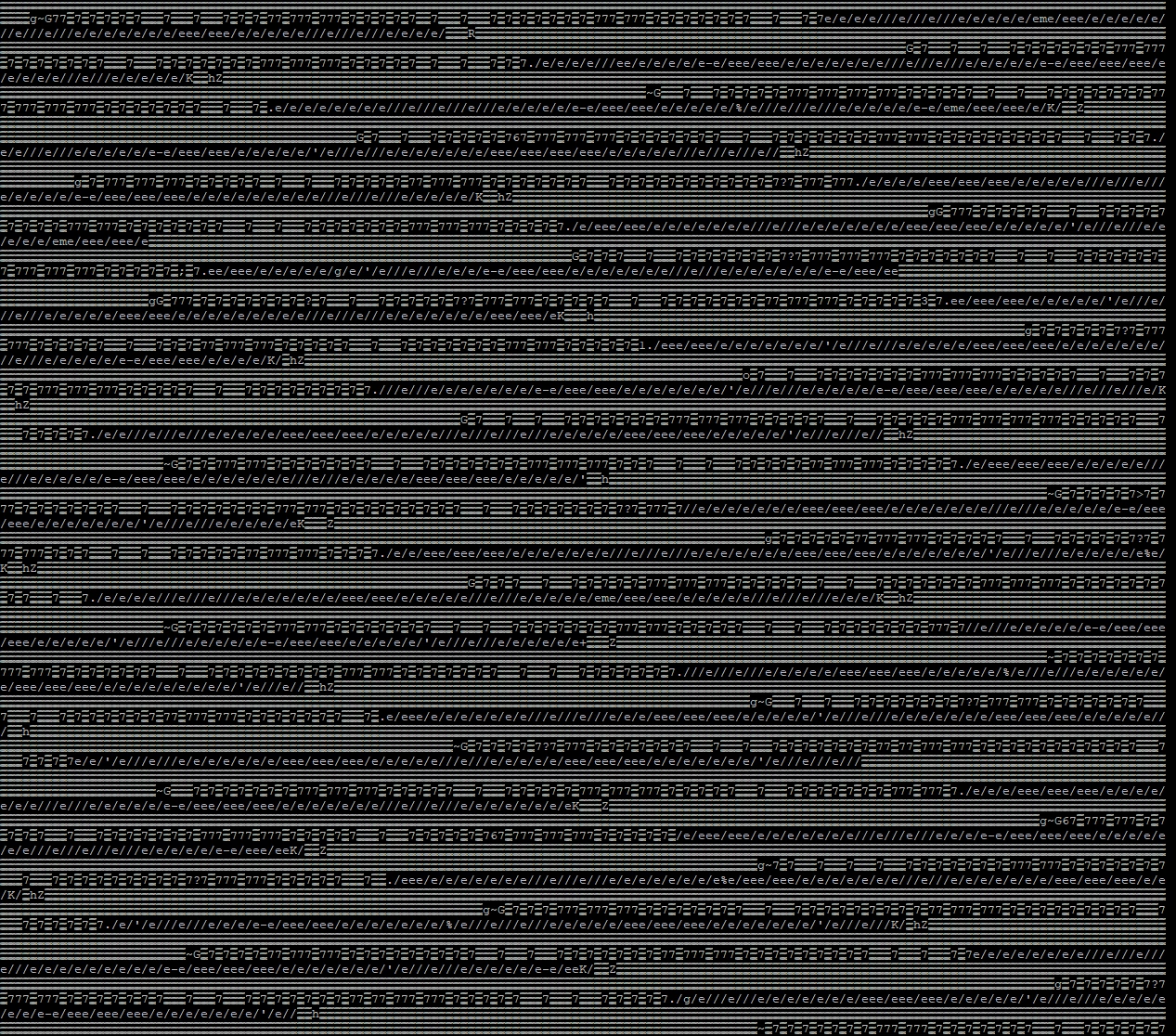

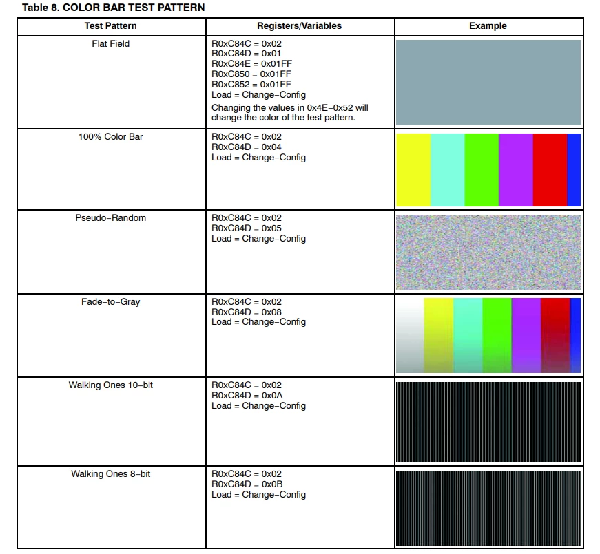

Now i am trying to print some patterns which are sensor supported like below image.
I configured FLAT field pattern(register values) through I2C in specific register. And reading again through I2C from pattern register, got same value which i configured. So which means pattern is configured properly.
Taking DCMI data like below and passing through UART,
#define IMAGE_BUFFER_SIZE (320*240)
uint8_t frame_buffer[IMAGE_BUFFER_SIZE] = "";
HAL_StatusTypeDef mt9m114_stopCap(){
 HAL_DCMI_Stop(&hdcmi);
 return HAL_OK;
HAL_StatusTypeDef mt9m114_startCap()
mt9m114_stopCap();
HAL_DCMI_Start_DMA(&hdcmi, DCMI_MODE_CONTINUOUS, (uint32_t)frame_buffer, 320*240);
HAL_UART_Transmit_DMA(&huart3, frame_buffer, sizeof(frame_buffer));
memset(frame_buffer,sizeof(frame_buffer),0);
return HAL_OK;
At present i'm getting DCMI Data like below image. This below image is screen shot of DCMI data in putty terminal.

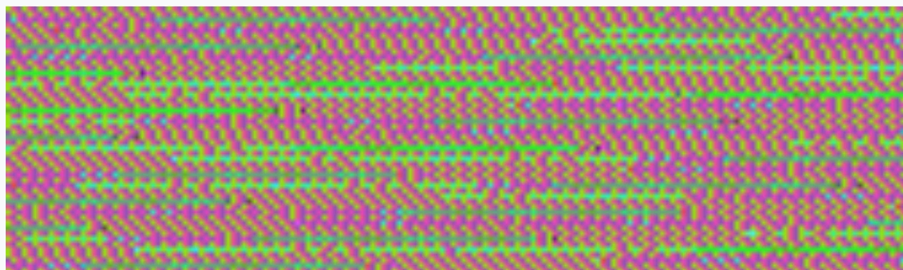

By using this RGB to Image converter "" https://codestation.ch/ "" result as like below. I'm unable to get Exact pattern which i expected.
Can anyone help on this issue , if i made anything wrong on DCMI part.

How on earth is this going to work? You've got no synchronization, the DMA functions return immediately, and then you clear the buffer. Not to mention the DCMI is continuous, and there's a huge disparity in the input vs output rates.
mt9m114_stopCap();
return HAL_OK;
