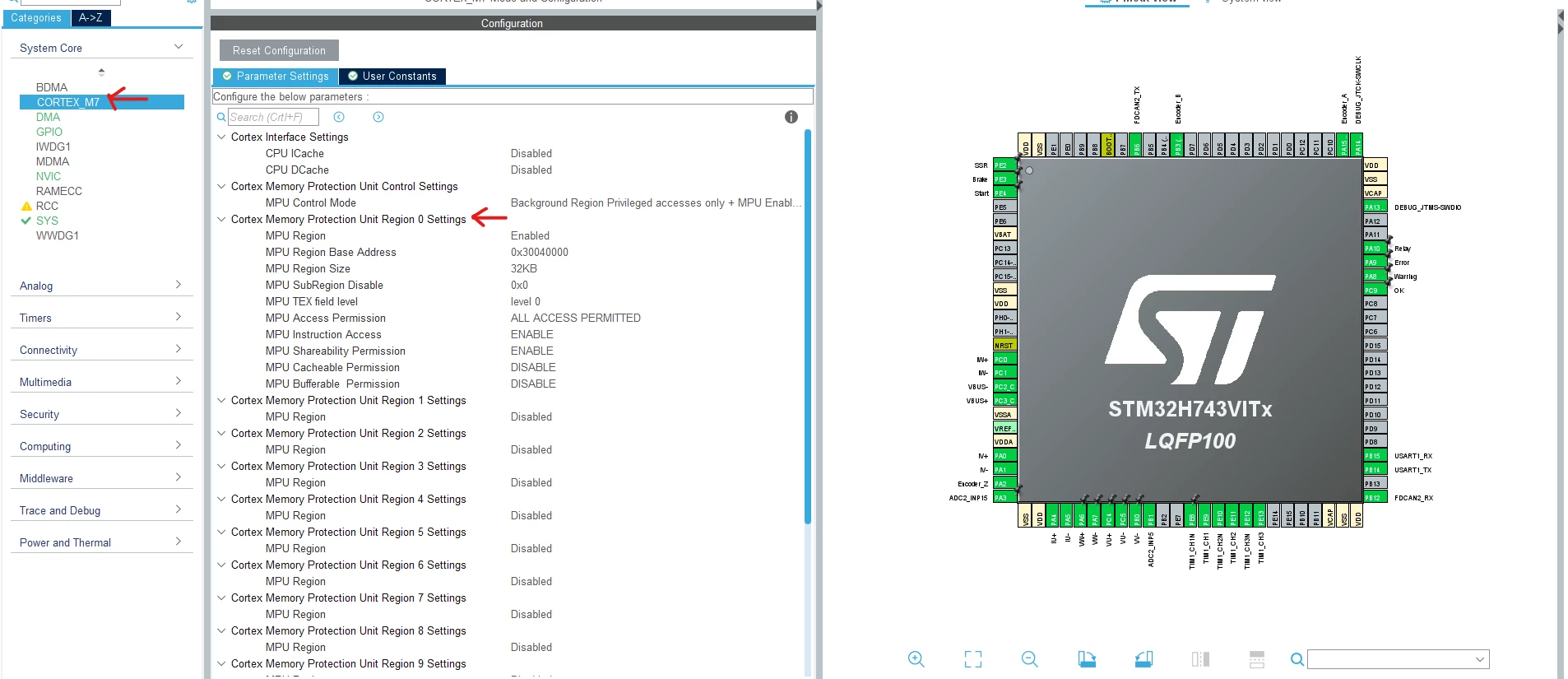

Dear all!
i'm handle graduation thesis project: " design driver for PMSM using STM32 base external mode with Matlab simulink"
i design hardware as PDF file, all block working without ADC, i try to set up by STM32cubeMX 6.14 but it still can't run, so can you help take a look and share the problem.

Hello @khanhcong861989;
By checking the PMSM.ioc file, I noted that you are using a higher ADC clock source.
I recommend you to refer to the datasheet and check the maximum ADC clock frequency for different STM32H743 revision (rev Y and rev V).
Also, I advise you to update your STM32CubeMX toolchain and your STM32CubeH7 firmware package.

Kaouthar!
many thank for yours sharing, i adjusted ADC clock frequency, and config MPU 0 then it ran already
