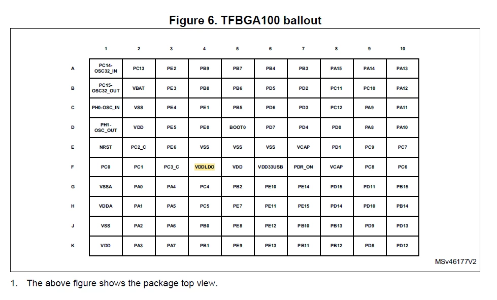

Hi, according STM32H743 datasheet VDDLDO pin in BGA packages can be supplied independently from VDD pins.
The problem is that on STM32H743VIH BGA package VDDLDO and VDD physically shorted in the package. Is the datasheet misleading or I’m missing  something?

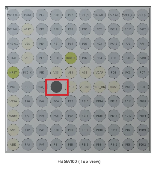

VDDLDO pin is available on the TFBGA100:
In CubeMx:

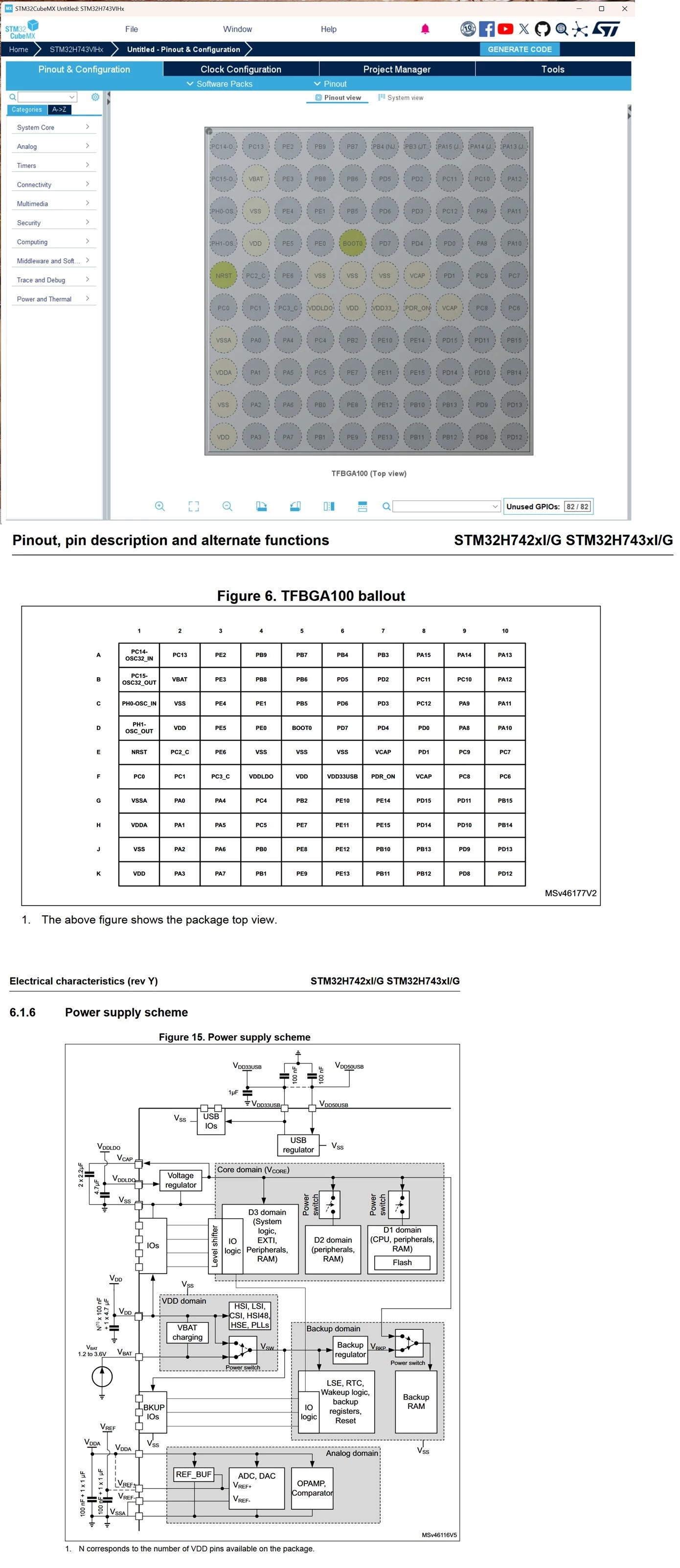

I know that VDDLDO pin is available, unfortunately it is available only in datasheet.
In the current design VDD bus is powered by 3.3V and VDDLDO by 1.8V. Once the system is powered, the 1.8V rail is bypassed by 3.3V rail, becauce VDD and VDDLDO pins are internally shorted inside BGA package (I measured connection on the multiple packages) even datasheet says differently.
