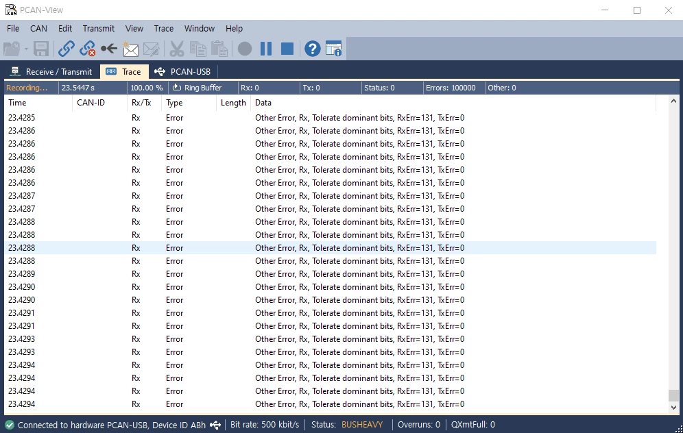

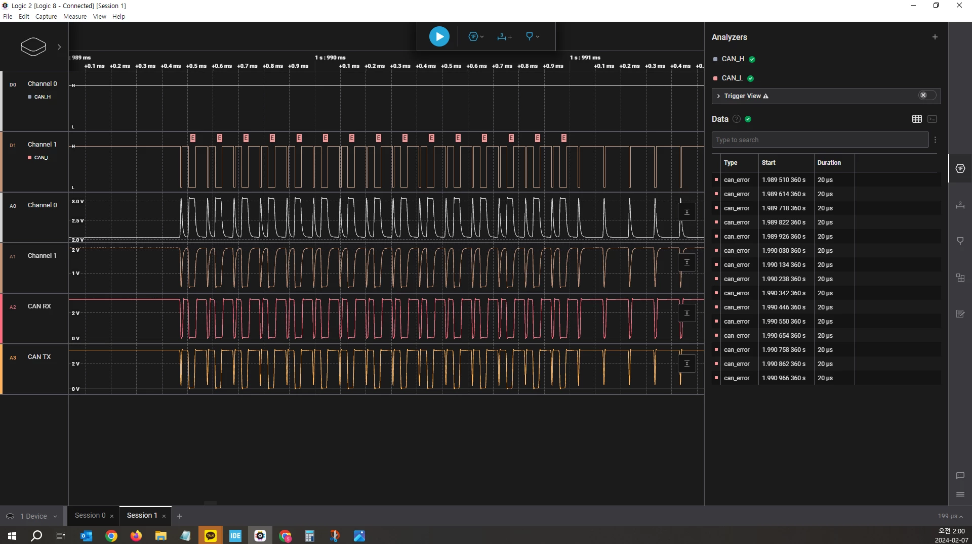

: My STM32H7 transmit only error.
Same error signal repeat endless and if I connect PCAN, many other error and stuff error occur and can bus status become BUSHEAVY.
I check where does HAL_FDCAN_AddMessageToTxFifoQ() return HAL_ERROR.
First transmission, HAL_FDCAN_AddMessageToTxFifoQ() return HAL_OK(but in Logic analyzer and PCAN, it is just error) and in Second transmission, TXFQS is 0x00 20 00 00 and enter a if state under and return HAL_ERROR.
I think it is become there was no ACK from PCAN. Therefore Tx Que in STM32 will not reset.
Maybe PCAN can't give ACK to STM32 because STM32 didn't transmit hole CAN frame as you can see upper logic analyzer screenshot.

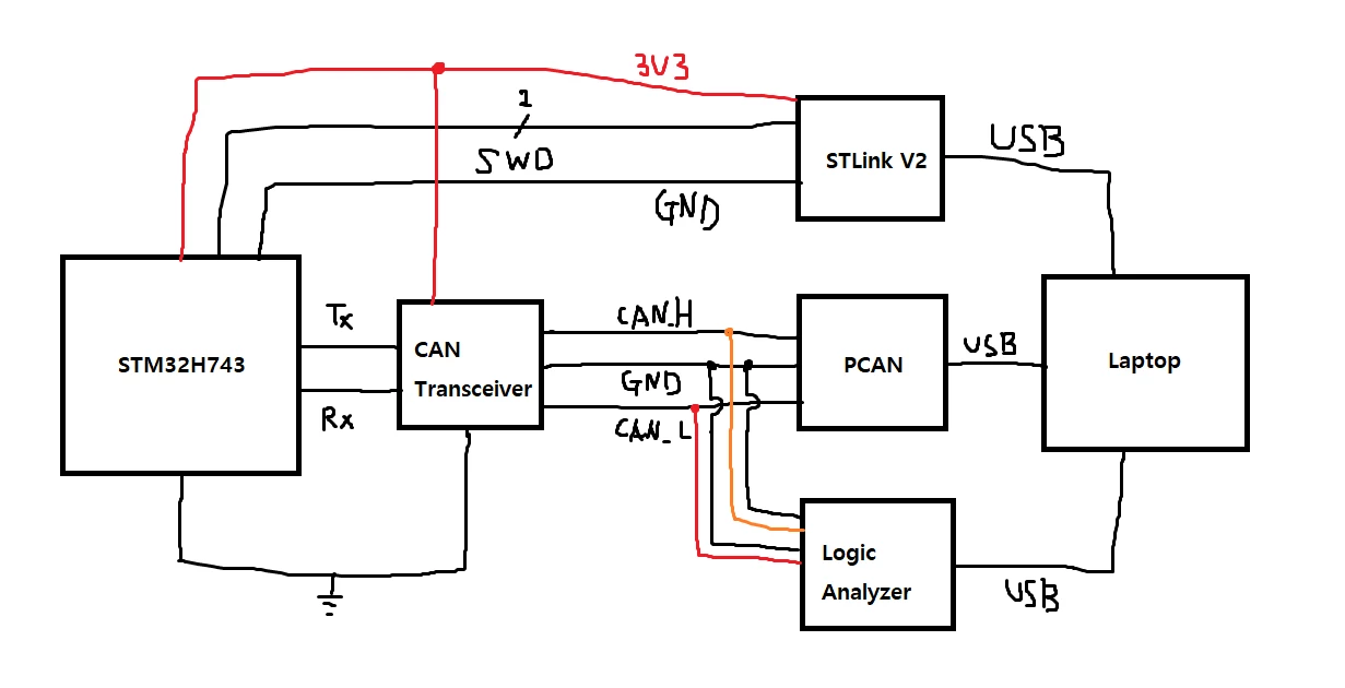

2. How I test CAN communication.
This is what I setup for debugging.
* I didn't attach 120 Ohm terminal resistor because length of CAN bus is short. (it is shorter than 50cm.)

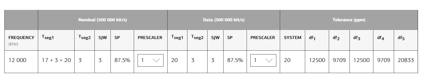

3.1 Bit timming and HW settings
I am using 12MHz for CANbus from HSE(12MHz TCXO) and SN65HVD231Q-Q1 CAN transceiver.
I follow this settings. Under code is in main.c -> static void MX_FDCAN2_Init(void)
  hfdcan2.Init.NominalPrescaler = 1;
  hfdcan2.Init.NominalSyncJumpWidth = 3;
  hfdcan2.Init.NominalTimeSeg1 = 20;
  hfdcan2.Init.NominalTimeSeg2 = 3;
  hfdcan2.Init.DataPrescaler = 1;
  hfdcan2.Init.DataSyncJumpWidth = 3;
  hfdcan2.Init.DataTimeSeg1 = 20;
  hfdcan2.Init.DataTimeSeg2 = 3;

CAN_H line is not changing in the screenshot you provide. Could you please check?
Also, I suggest to add 2x120 ohms on the line even the length is short (just for the test).

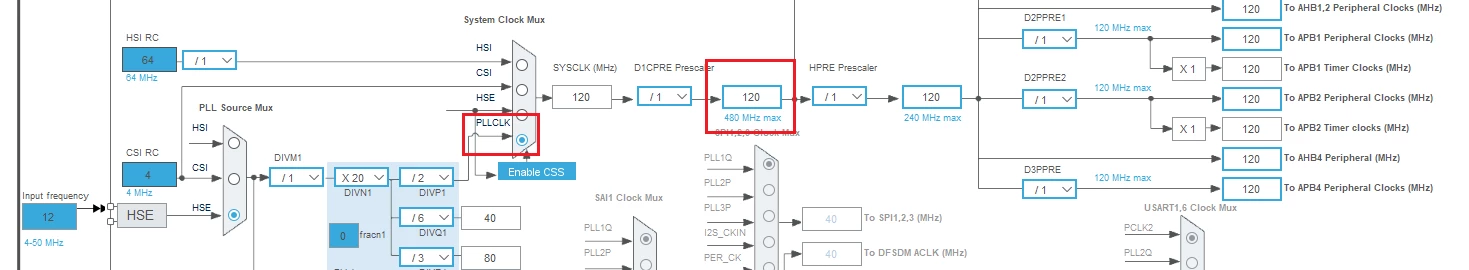

Also could you please increase the system clock using PLL (for example @120MHz)and keep FDCAN clock source as HSE? (just for the test)

I did some tests playing with system clock and FDCAN kernel clock and this is a table summarizing the results:
I don't recommend you configuration.
To be safe choose FDCAN kernel clock less or equal than Sys clk / 2

I get some hint from your first suggestion(CAN H is not changing) and I found there was 330Ohm resistor between CAN transceiver and MCU. It increase RC constant of signal line. I delete this 330 Ohm resistor and add 120 Ohm termination resistor. These actions make CAN works!
I increase system clock to 75MHz too.
