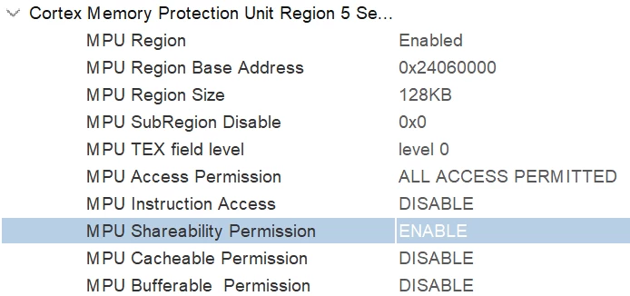

The MPU is enabled and set as follows:
I set AXI_TARG7_FN_MOD.READ_ISS_OVERRIDE to 1 according to STM32H742x/743xI/G, STM32H750xB and STM32H753xI device errata section 2.29.
As an experiment, I added a section of AXI SRAM to the MPU config, set it to full access and placed my source buffer at that address.  The transfer happened correctly.  There were no gaps.

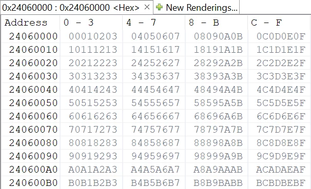

Thanks for responding.  Valid point.  I did see a difference between the compare fails vs. what was on the Memory viewer.  There are addresses that don't fail, but show up as 0 instead of the written value in the Memory viewer.  However there are still gaps that fail (read 0) which also show up as 0 in the Memory viewer.  I used an incrementing data pattern as TDK suggested.  A fail log snippet is shown below (the address reported is the offset into 0xD0000000, the SDRAM space).
sdram read fail: exp c, got 0 at 70c
sdram read fail: exp d, got 0 at 70d
sdram read fail: exp e, got 0 at 70e
sdram read fail: exp f, got 0 at 70f
sdram read fail: exp 10, got 0 at 710
When I create a section of the AXI SRAM that has ALL ACCESS in the MPU config and place the src buffer at that address, the fails go away.
I'm trying to understand why this works.

Thanks for responding.  I tried the data pattern you suggested and I see that the data gets transferred correctly until a 0 gets written in place of the expected value.  See my answer to Pavel above for a snippet from a fail log.
