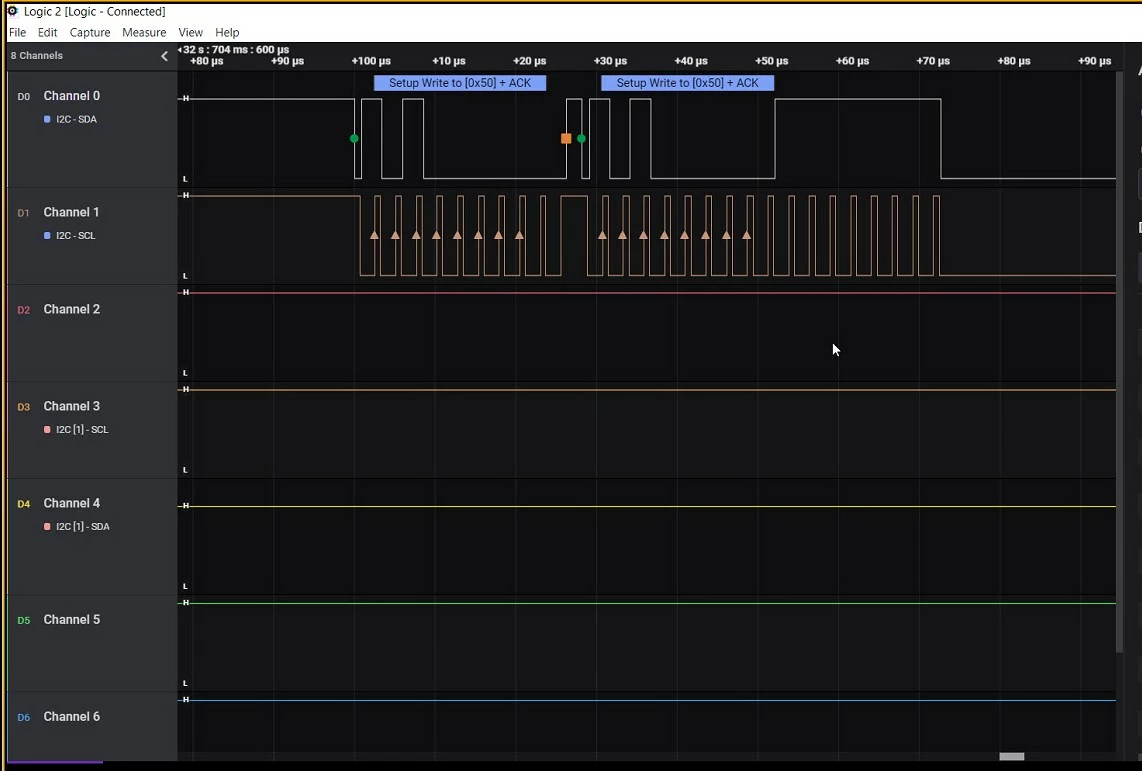

STM32H743BI, I2C becomes busy after two hours or five hours randomly. Some times there is no issue.
  • February 11, 2022
  • 0 replies
  • 655 views
We are using I2C channel 1 for EEPROM and RTC (Semophore used for exclusive access) and I2C channel 2 for Touch controller. Both I2C runs at 400KHz. Everything works normally, Suddenly I2C channel 1 becomes busy at random time. It is really hard to reproduce this issue. We have captured I2C channel 1 data in Logic analyzer during problem scenario. What we observe is both data and clock line goes low and in ISR register BUSY flag is SET. Refer attached logic analyzer output image.
Is there any reason for this behavior?
