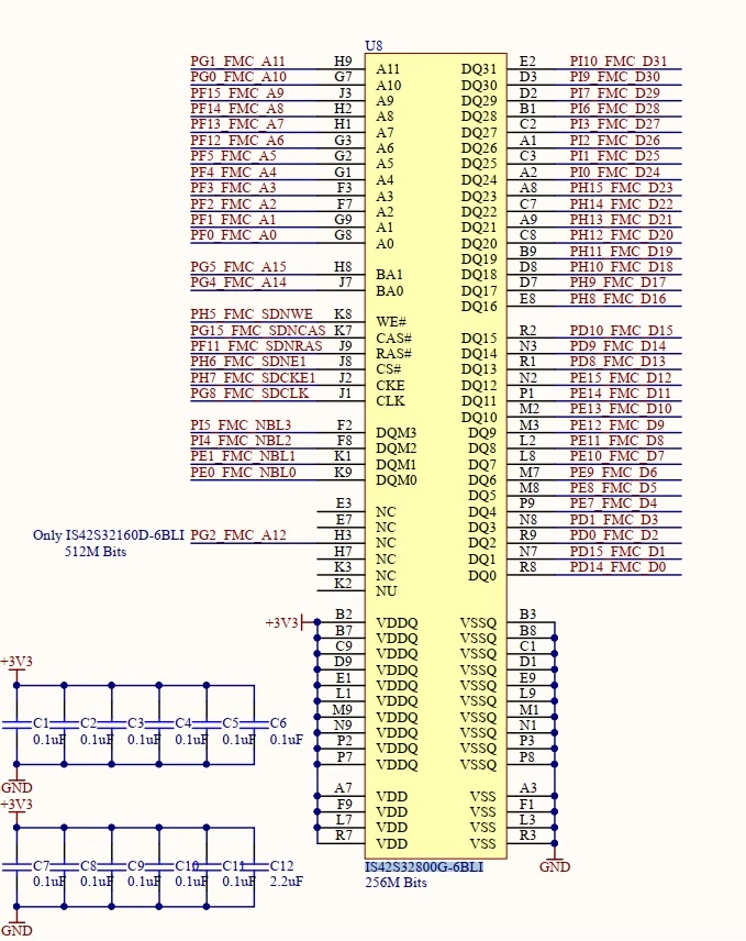

Hello Everyone ;
we are new to STM32H7  ; we used before stm32f4 in many projects but STM32H7 we still new; so I am sorry to ask simple questions.
We have designed our board based on STM32H743BI and SDRAM IS42R32160F-7. After a couple of weeks of trying to access the Sdarm, we could not make it work; sometimes we could read and write a few bytes ; sometimes up to 1k bytes but not more, and always crashes. It could be a clock setting problem or timing problem; or a connection problem between the MCU and SDRAM.
The MCU crystal is 12MHZ our goal is to run the MCU at 480MHZ and SDRAM at 100 MHZ
Let's start step by step please ;
my first question is to verify the pins connection please and SDRAM BANK; we assume that is should be bank 1  and mapped at  0X70000000 address.
could you confirm it please?

is the pins connection right ?

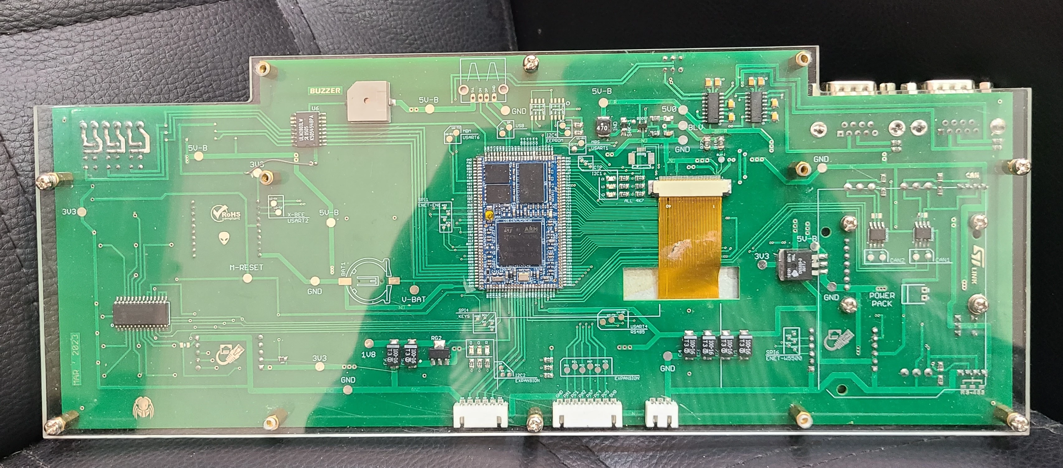

I am using 256MB SDRAM with STM32H745XIT6 (DUAL CORE) with TouchGFX at BANK 2 without any problem.
here is my custom designed board with STM32H745XIT6 & 1024X600 TFT.
CM4 running Modbus Master RTU
CM7 running TouchGFX with 256MB SDRAM

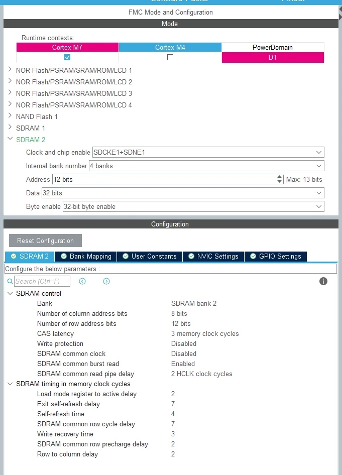

Here is the configuration in MX
Please check the timings of interface .
Imran

Hello IMRAN
very nice project ;
Could you tell if my connection is right or not?  in fact our goal is to use  TFT LCD but we still not making the SDram working.
Thank you

June 22, 2023
Hello Hector ...
In quick view , your interface looks fine .
are you using any SOM or your self developed board for every thing .
I have lot of experience working with TFTs & TouchGFX .
I can b helpful to solve the issue.
Imran
