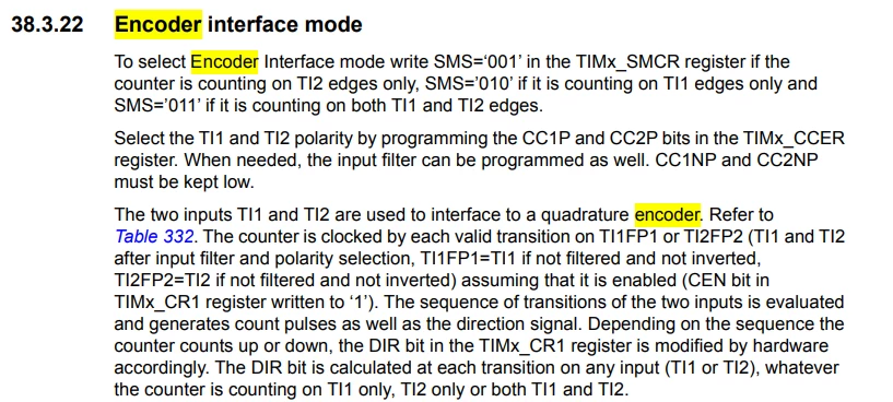

> Trigger controller / Slave controller / Encoder interface is just like black box, no good explanation
Did you read this section? What is unclear? Only a partial screenshot.
Maybe you're mistaking the datasheet for the reference manual.
