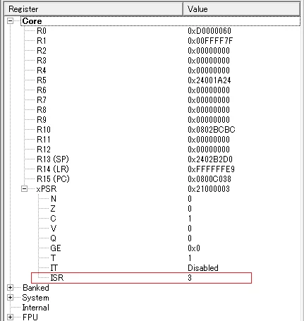

SCB->ICSR, its value was 0x00000803,it indicates a hard fault.
I will attempt to create an environment with a minimal setup to reproduce the same issue...

I will provide a screenshot of the SCB->ICSR register and xPSR state at the time of fault.

The cause of the issue was undefined behavior due to the initialization order problem of the static instance.
