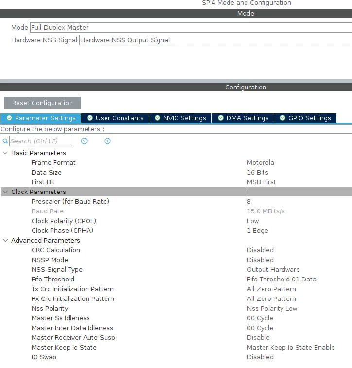

SPI4 configuration:

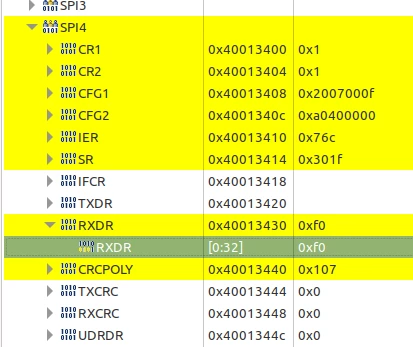

I checked the SPI4 RXDR and it contains the data the scope shows on the MISO line.  This data is not making it to the buffer pointed to in the HAL_SPI_TransmitReceive call.

As an experiment, I made a read of the RXDR after the HAL_SPI_TransmitReceive_IT call like this:
uint32_t rxdr = Inst->hspi->Instance->RXDR; (note the value of the RXDR register is 0x000000000000F)
and noticed that the RXDR, clears when read, and the value of rxdr is 0.
So assuming that if the value in the RXDR register is my data and the register clears when the data is transferred, then I must conclude that the process of transferring the data to the receive buffer is not occurring, otherwise, I would expect the value in the RXDR register to be 0 after the HAL call.
The process I use for SPI transfers is the same for SPI1, SPI2, and SPI4 and the set-up is the same except the SPI4 is setup as 8bit while the others are 16.
I am beginning to think this is a bug in the silicon unless I have missed something.

Further investigation:  I cannot use the instance to see the Special Register for SPI4->RXDR.  It shows 0 while the SFR's tab in the debugger shows:
So there is a disconnect there and I am not sure how the Instance structure gets updated.

Sure would like to know why when accessing the RXDR register via the hspi->Instance, the data contained after the HAL_TransmitReceive call goes from 000000000000000f to 0 and the value returned is 0?
Spent most of the day going over RM0433 with a fine tooth comb and find nothing that would solve the current behavior.

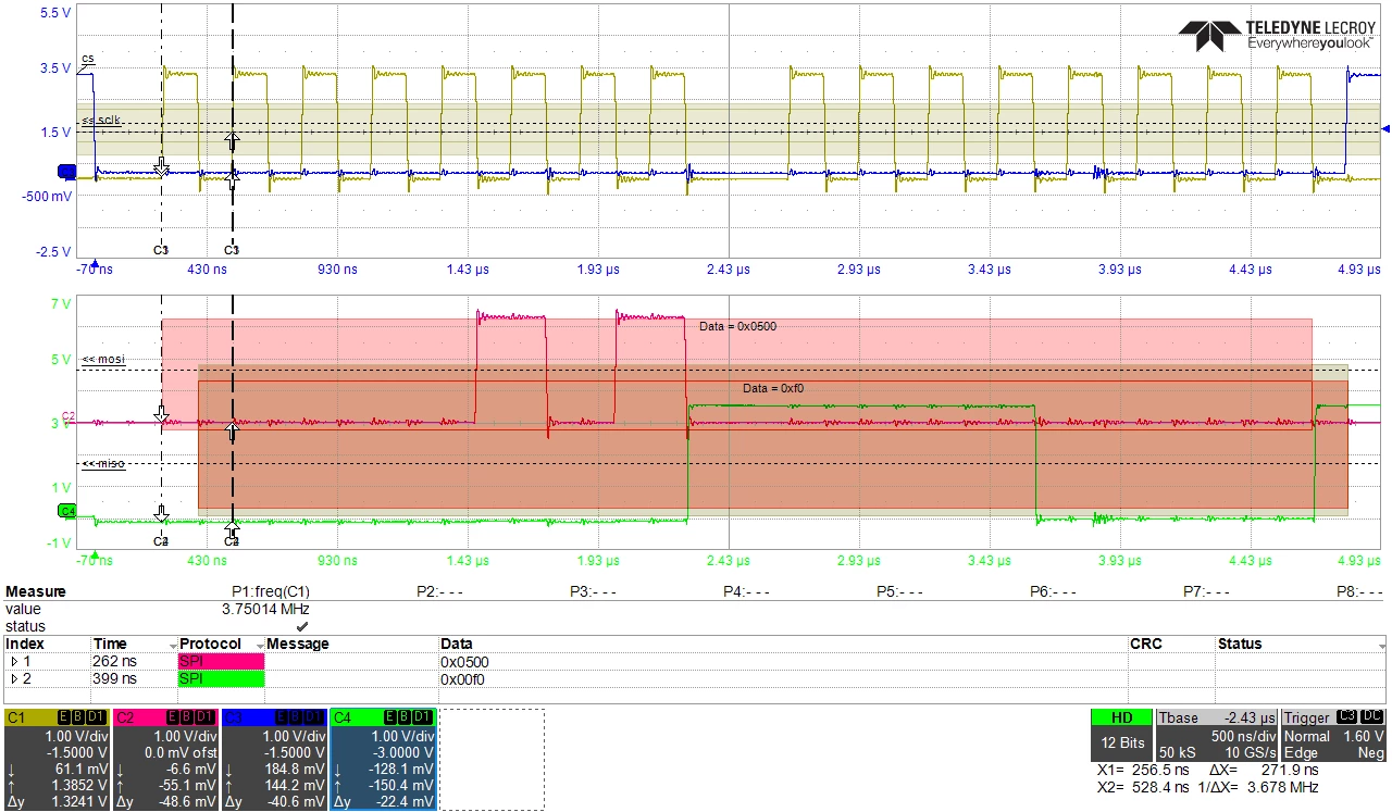

I removed the EEPROM part from the board and shorted MOSI to MISO.  The data sent was not returned.  The data returned was 0.
Here is the scope shot with the EEPROM mounted as probed at the EEPROM.
I have verified that the MISO from the MCU to the EEPROM has good connectivity by configuring the MISO line in the MCU code with a pull-up and with a pull-down (2 different cases) and while the SPI4 is idle measure the MISO line at the EEPROM.  The measurement shows HIGH pulled-up case and LOW in the pulled-down case.  After removing the EEPROM and shorting the MOSI to MISO at the EEPROM location.  I repeated the the same cases and noted that inspecting the GPIOE, pins 5&6 show HIGH when pulled up and LOW when pulled down.
The connection is good.
I am certain at this point the the MCU SPI4 is broken!  Guess I will have to disable SPI4 and bit bang the EERPOM.

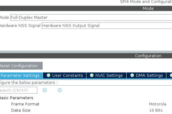

What i not understand:
you state : SPI4 is setup as 8bit .
but on top you show: 16b
What now ?
in timing diagram i see clk + data send on mosi ;
so what coming on miso then ? (and dont forget, you read from a fifo, not a static register. This works only 1x , then data away. -> 0x0. )
why you write: RXDR register is 0x000000000000F -

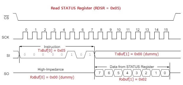

uint8_t readStatusRegister()
 uint8_t TxBuf[2];
 uint8_t RxBuf[2];
 TxBuf[0] = 0x05; // RDSR Instruction
 TxBuf[1] = 0x00; // dummy
 HAL_SPI_TransmitReceive_IT(&hspi4, TxBuf, RxBuf, 2);
 // RxBuf[0] = 0x00; //dummy
 // RxBuf[1] = 0x02;
 return RxBuf[1];
GreenGuy
GreenGuyAuthor
Senior III
May 17, 2024
Yes this is appropriate for the M95010-W EEPROM and is precisely how I applied it.
However, in my case the Data from the status register while visible on the scope did show up in RxBuff[1], but rather 0x00.  You may need to back track through the post to find the scope shot.  At least I hope it is still there.
