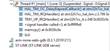

So i tried to change my linker script according to that, placing the ".data" ".bss" and " ._user_heap_stack" to ">RAM_D1 AT> FLASH" (before it was ">RAM_D1"), removing the initial "_estack" definition and adding "_estack = .;" inside " ._user_heap_stack". But when i do this is like if the program was always attending interruptions and cannot run the application:
Any help would be really appreciated!
