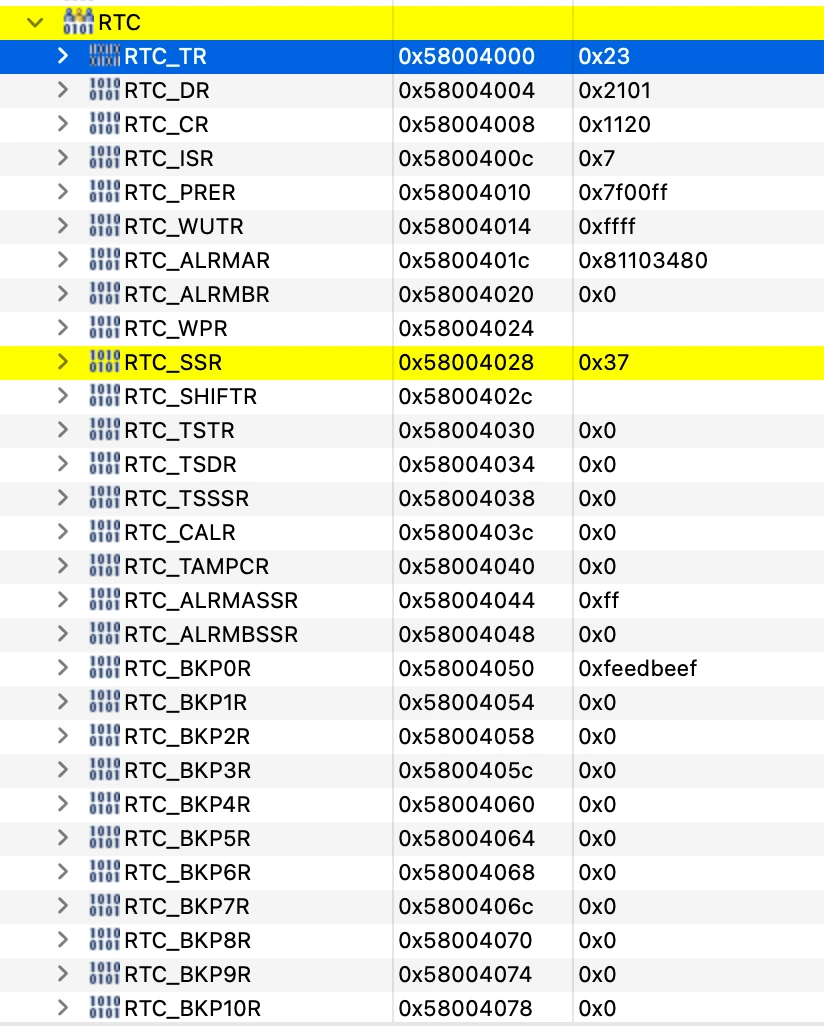

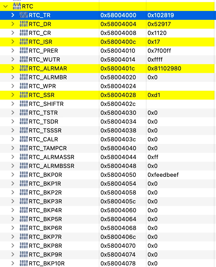

I tried setting a watchpoint on RTC_TR and it doesn't trigger on reset, it triggers only when I set the clock through my UI.
Here are the registers after I set the time & date, and then immediately after resetting (first line of SystemInit()):

ron239955_stm1AuthorBest answer
September 17, 2025
As is often the case, it turned out to be my fault. I didn't realize that my bootloader had that Cube generated RTC boilerplate code that resets the date and time every time. This explains why power cycling the unit would reset the clock.
The debugger case is a little weirder. The bootloader wasn't supposed to run when I ran the code through the debugger, the entry point is different. Nonetheless, it seems to be retaining the time and date in debugger as well, so I'll call it solved for now.
