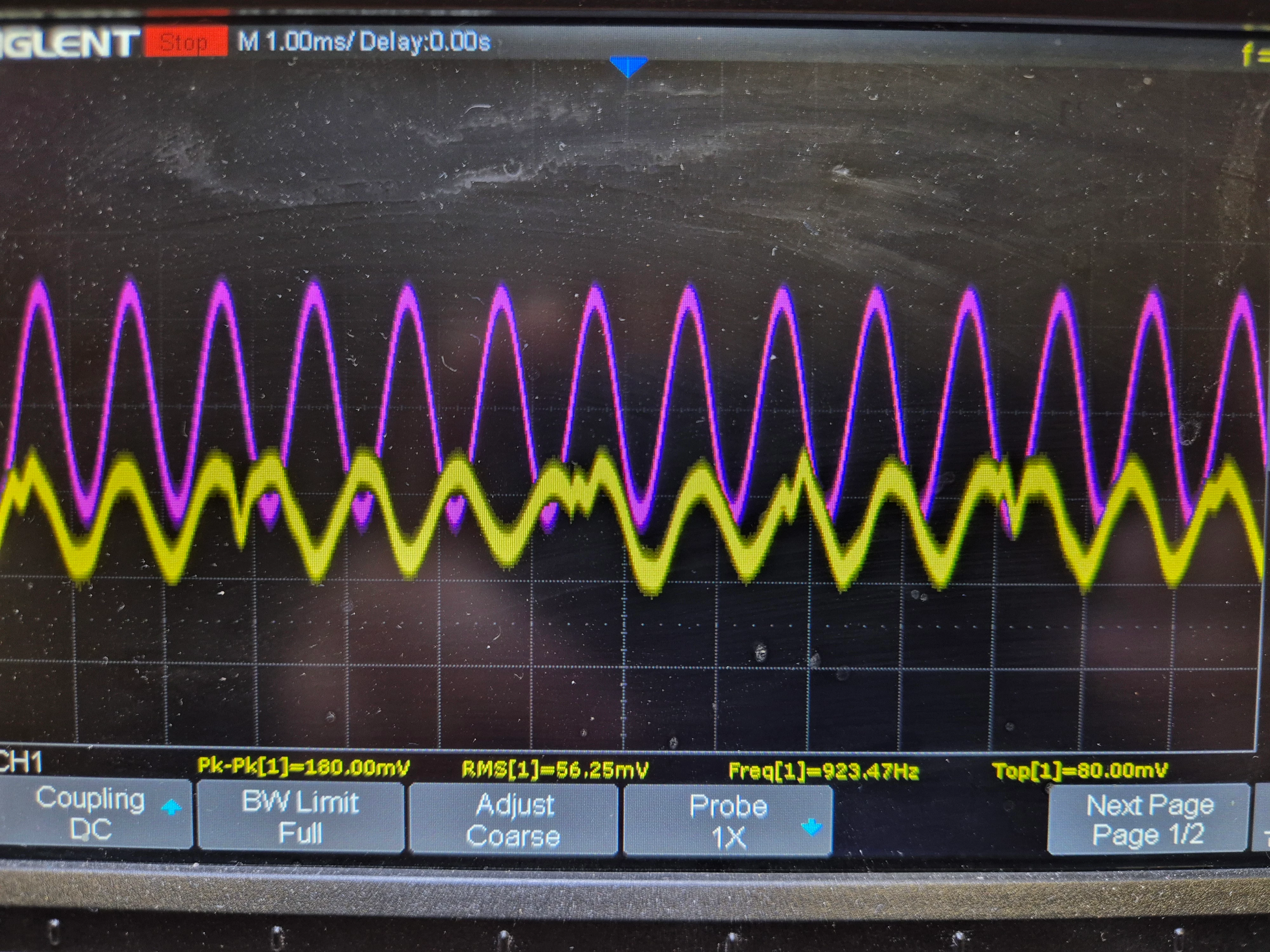

This is the cleaned up code that does the audio processing. The truth is that I need to measure the "time cost" of the Calc_IR() function. Also I send a photo of the oscilloscope with 1Khz sine wave. You will notice that the yellow has some noise (maybe high frequency) but you need to notice the "glitches". It is like the buffer is misalligned or something. I cant understand why this happens. I even tried Overlap-save code with arm_copy_f32(), arm_rfft_fast_f32(), arm_cmplx_mult_cmplx_f32() functions from CMSIS library but I had no luck.

So, what I said in the first post, the H7 is not made for that.
50k cycles is just too many, but maybe you can optimize your code, maybe using integer math is good enough.
But do you at least get out what you put in without any processing?

Then compare the function Do_Reverb() to your FIR filter concerning execution time.
I'm pretty sure that the cause for the glitches is the setting of the I2S buffer pointers by the interrupts:
- the processing starts in main loop with the data ready flag
- while the "too long" processing takes place, the I2S (or SAI) interrupt sets the buffer pointers -> glitch
My guess is that the problem is gone with lower FIR filter taps.
And I would try to measure cycle counts for the complete signal processing, including the float conversions.
