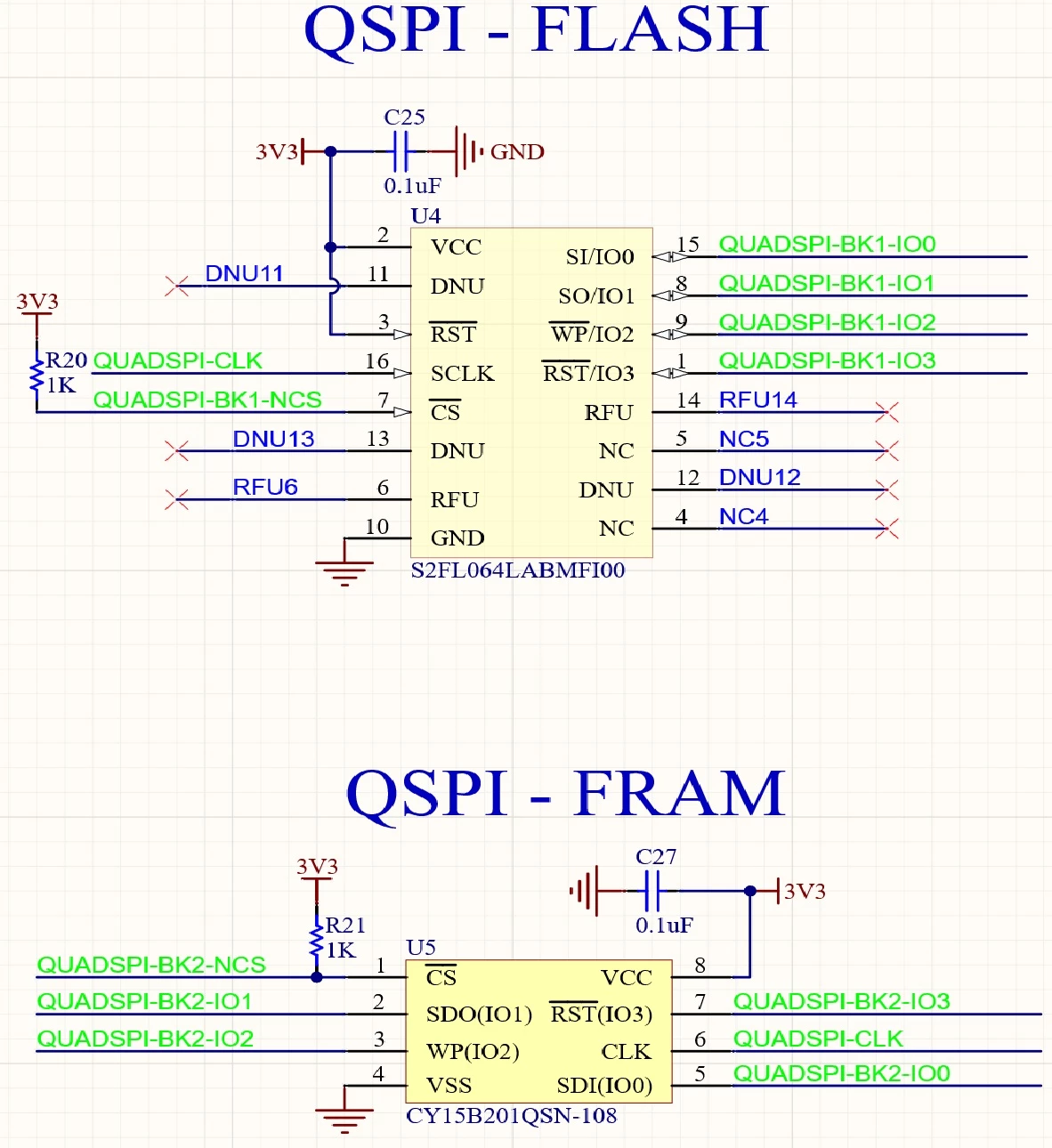

i am using STM32H43 QUADSPI and i have configured BK1 to control a flash and BK2 to control a ram
BK1 works flawlessly when FSEL - 0 (U4, flash1 selected) but BK2 cannot work properly when FSEL = 1 (U5, flash2 selected)
just sending a read status register 1 instruction (common for both devices) only command to the devices is the easiest way to check the hardware working proper or not
the same code works on BK1, i got toggle the WREN bit and read it out but not on BK2
i can see all the correct waveform on BK1 but when flash2 is selected, BK2-IO0 which is the SI for the ram U5 do not have the instruction bits which was present on BK1-IO0 when flash1 was selected
so, the only way to find out what is happening is to get sample working code to use it confirm if my setup is correct
my schematic follows the recommended connection in the ST reference documents for two independent flash
the only connection that is common is the quadspi-clk, see attachment

Hello @JTse.1,
In case of two different memories, before switching from quad-SPI memory to another, it’s recommended to reconfigure the QUADSPI interface accordingly the desired memory specification.
Also, make sure that:
  • The Dual_Flash mode must be disabled (DFM=0)
  • The data transmission to be completed before switching from quad-SPI memory to another.
Also, I advise you to decrease the QUADSPI clock frequency that may help you to solve the issue.
Could you please share the QUADSPI configuration and memories datasheets?

i tried at all frequencies and i have tested all modes I tried to use Dual flash mode only to check the BK1 & Bk2 IO with a scope to see if all of them are toggling properly, logically, in Dual Fash mode, both BK1 and BK2 should be working identically.
but no use, the BK2-IO0 and BK2-IO3 is still not working, even in dual flash mode.
i am currently using 80Mhz only to ensure that there are no timing issues even though it can work at higher frequencies
the main problem is that BK1 works completely, in single line classic SPI mode or quad line QSPI mode
but BK2 totally cannot work even with the same code but with FSEL = 1
i have tested all BK2 IO lines with dedicated IO mode and confirmed that all those lines are working and not shorted or OC
situation is that during FSEL = 1
QUADSPI CLK is common and so it is working
BK2-NCS is working, so confirmed that device 2 is selected
just in single line mode, exactly the same as a classic SPI,
BK2-IO0 do not have any 8-bit instruction out at all, always low
also, BK2-IO3 is low, which is the chip rst in classic spi mode, so the chip is always in reset, this do not happen in BK1-IO3 when FSEL = 0
there is why, it is impossible to carry on without manufacturer's help, at least give me some proven code examples to test!!!

i have even attached my schematics, which not only have all the part numbers, also all the io names and connection
is it not good enough?

unfortunately, all the examples are non-configurable
so, i am not able to actually run it due to IO different.
i am using the QSPI_MemoryMappedDual example to check out the setting,
just ported all the settings to my hardware but using my IO so that i can monitor it on the scope.
it is not important that the example do not completely work, i just want to monitor the physical IO to see if they work as expected which in dual flash mode should meant that both flash data lines must operate correctly.
i could only single step up up to all the config part and get the setting for all the registers
and also see the first command and assembled the same command to send
still, when i do the same setting in my code for dual flash mode, single line classic SPI mode
the BK1 part works fine but the BK2 only partly works
BK1-NCS and BK2-NCS is working fine and so both chip is selected
BK1-IO3 is high as expected
BK1-IO2 is low as expected
BK1-IO0 has pulses as expected which is the instruction byte being send to the chip
but BK2-IO3 (RST in single line mode) is constant low = should be high as in BK1-IO3
also, BK2-IO0 (SI in single line mode) is constant low = should have the same pulses as in BK1-IO
this supposed to be dual flash mode, yet BK2-IO0 & IO3 is not the same as BK1-IO0 & IO3
so, flash 1 all lines worked as expected but flash 2 two lines did not work at all.
