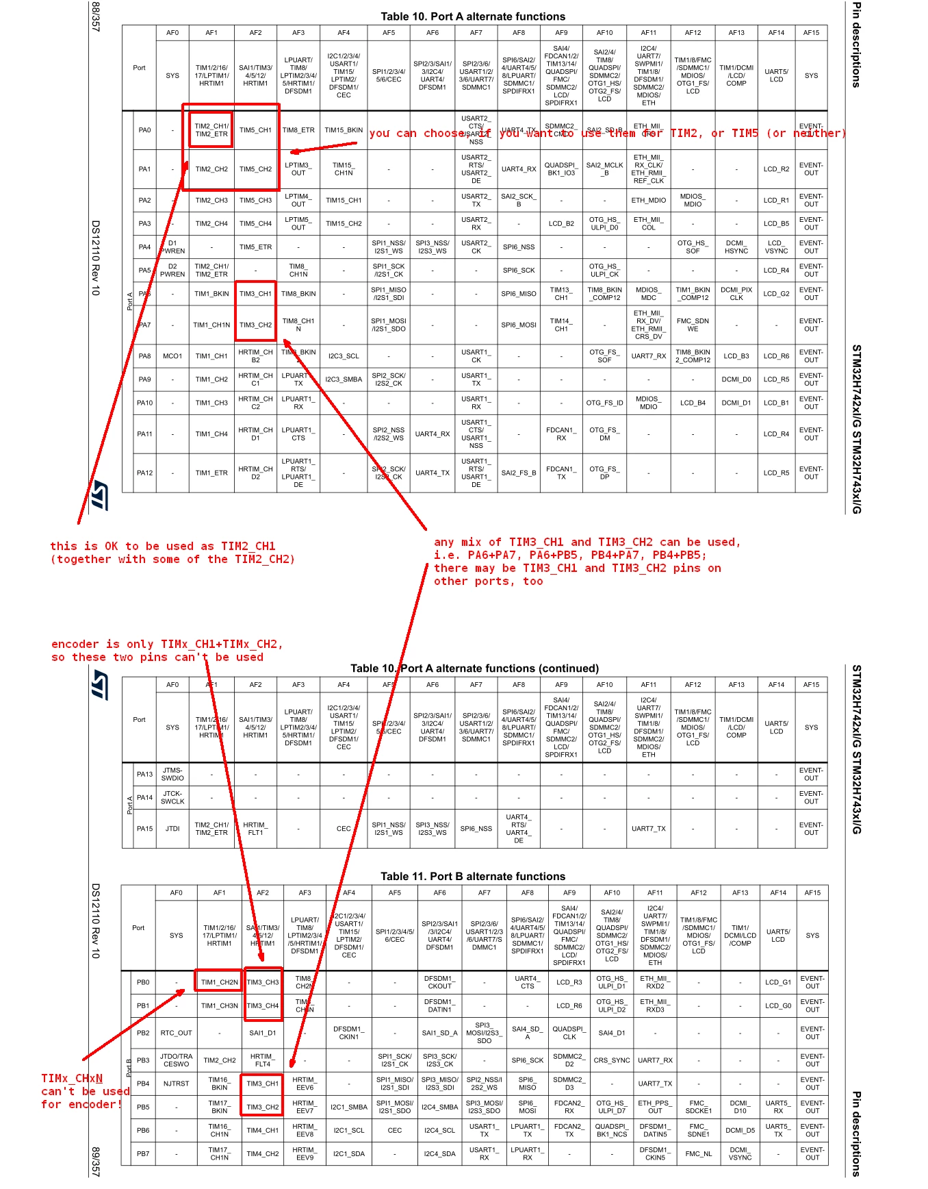

> is it true that any I/O pins can be chosen with this Timer encoder mode
Only TIMx_CH1/TIMx_CH2 pins.
