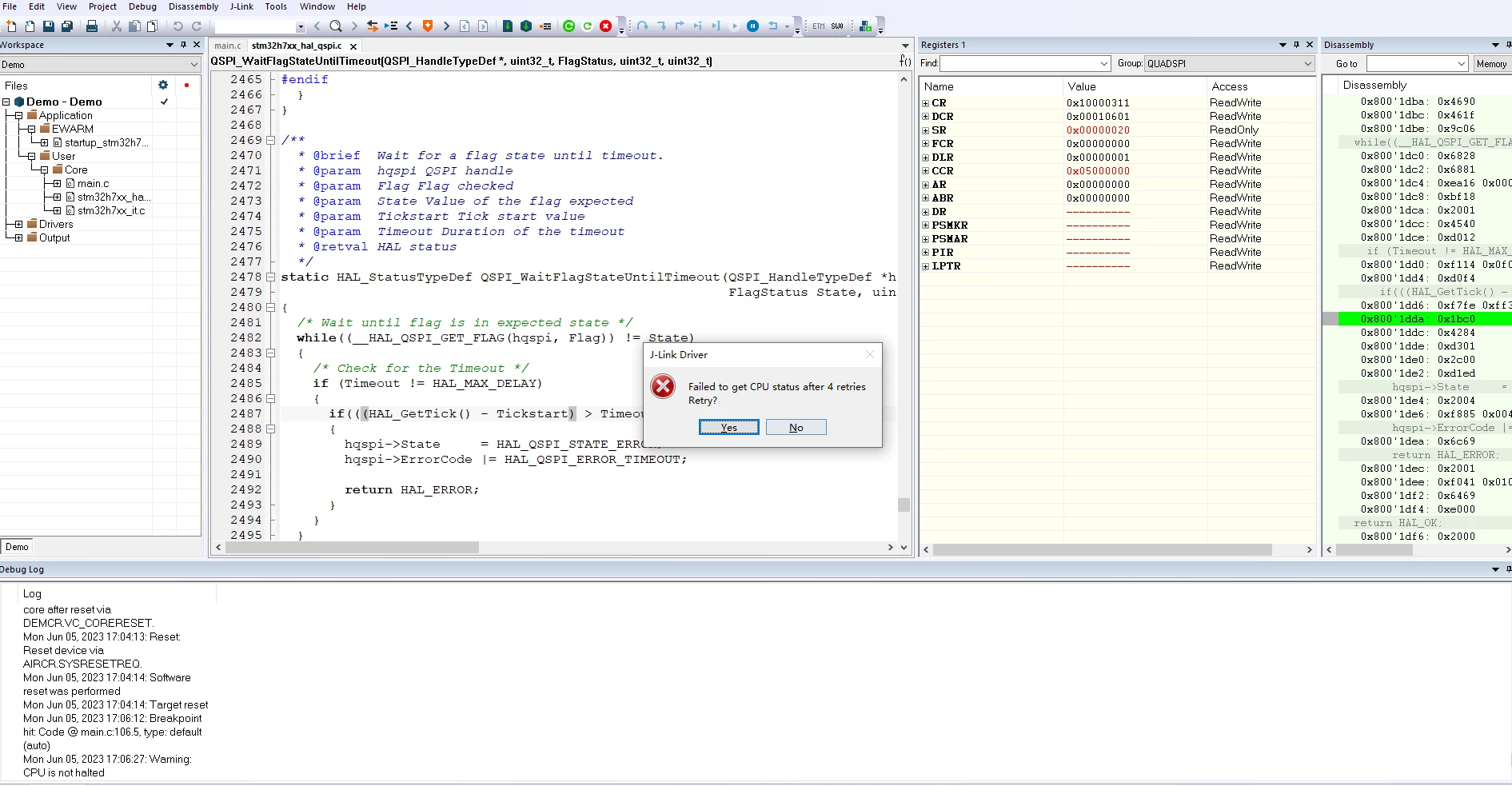

if the DummyCycles = 0,the program is running abnormally.
_legacyfs_online_stmicro_images_0693W00000dK0VFQA0.pngif the DummyCycles over 2,the program is normally.

_legacyfs_online_stmicro_images_0693W00000dK1DRQA0.png​When the dummy cycle set 0, the application freezes and needs to be powered off and restarted to emulate。

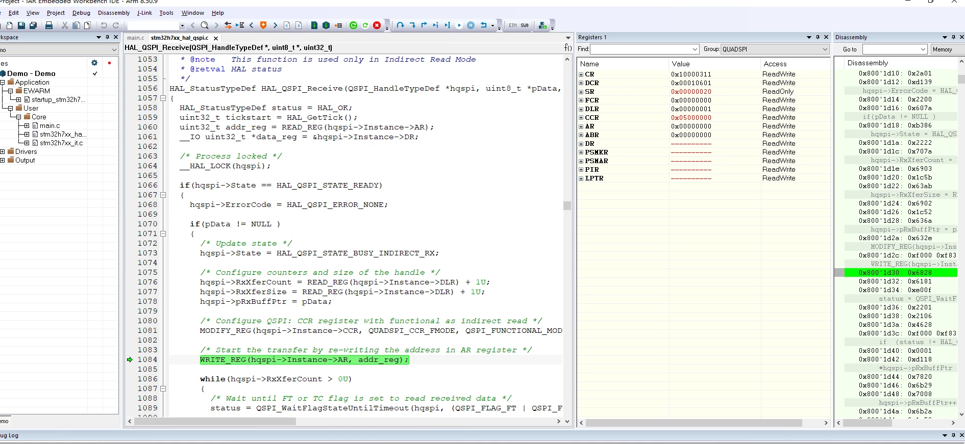

_legacyfs_online_stmicro_images_0693W00000dK1HeQAK.png​

Hi @wu qw​ ,
Are you using the indirect read mode?
It is mentioned in the errata sheet ES03932, for the STM32H743 MCU , when the QUADSPI is configured in Indirect read with only the data phase activated (in Single, Dual, Quad or Dual-quad I/O mode), the QUADSPI peripheral hangs and the BUSY flag remains of the QUADSPI_SR register remains high. An abort must be performed to reset the BUSY flag and exit from the hanging state.
Workaround: Insert a dummy phase with at least two dummy cycles.
Thank you.
