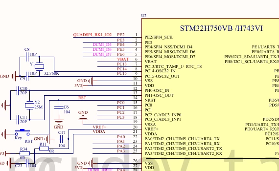

I have a chinese STM32H743 Board, with a 25Mhz Clock Source and sdcard 3.3V VDD.

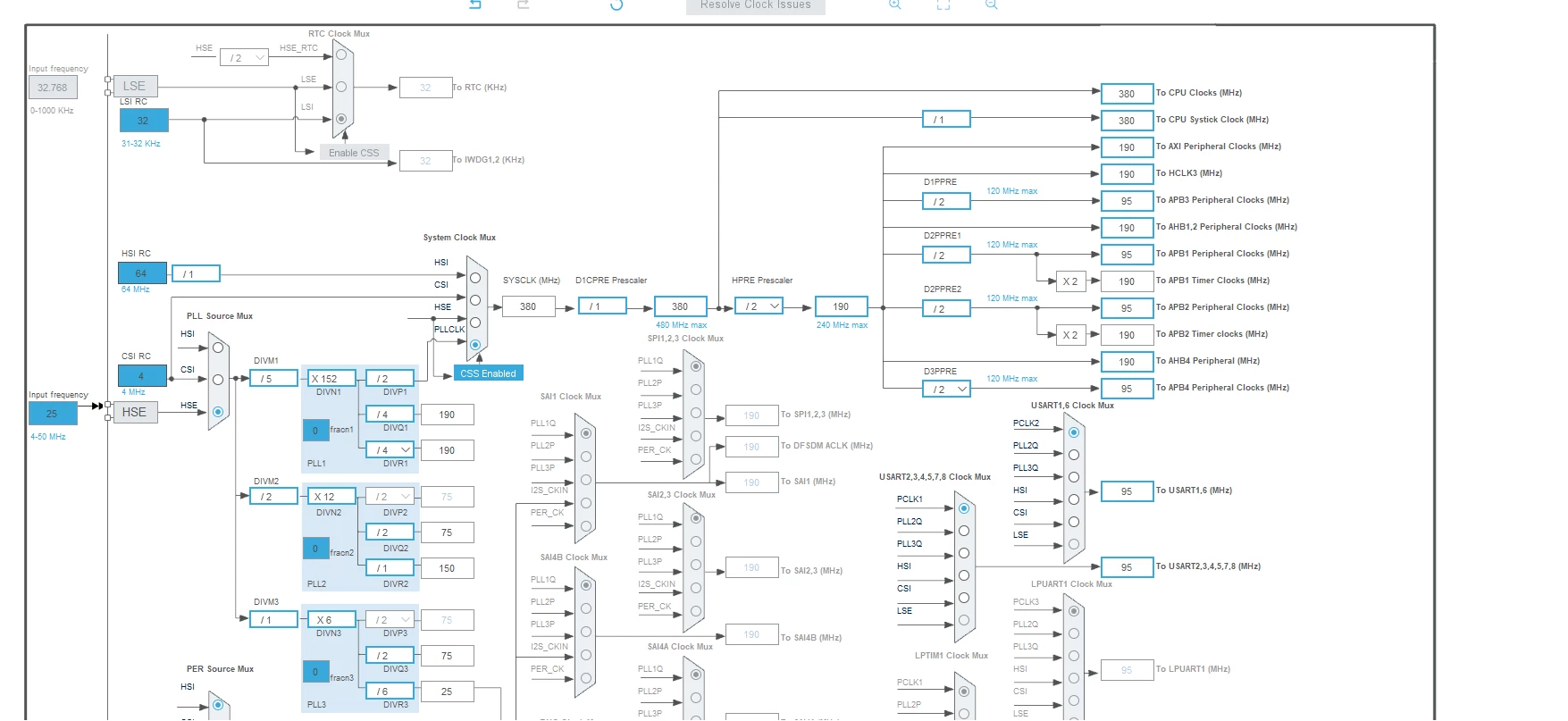

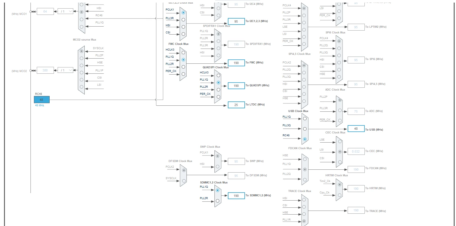

my clock settings:

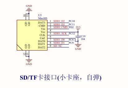

if you talk about the DEV-E board, H743V , i have it also :
25M clock and sd-card:
+ check: you set it using the correct pins !
Try with 1bit mode first...and set pin speed medium, withh pullups ON (on all pins);
Mine is working fine, at full speed (100M + div1) , 4 bit mode.

Hey,
Wiring works fine, the Clocksignal for the Card is fine.
