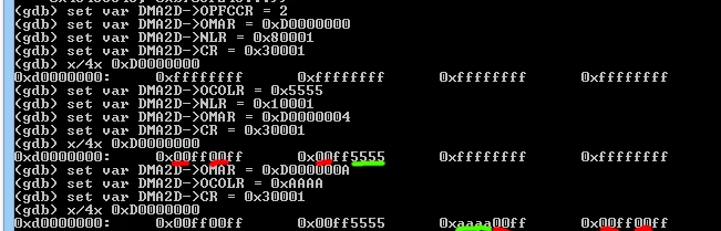

    So, I did some more detailed investigation of what is going on with DMA2D. Here is a first gdb console screenshoot:
    You can see I programmed DMA2D to fill the 8 words (16bit pixels) starting from the 0xD0000000 address with 0xFFFF. This operation was successful cause address and line size were 8byte aligned.
    Then I programmed DMA2D to emit one pixel at 0xD0000004 address with 0x5555 ''color''. You saw what I got (the green underline indicates right and expected result, the red underline is the problem) - the unusual thing is that

    as I thought before). Then I repeated one pixel operation for the 0xD000000A address and got the same result. I have no mind what is going on (chip problems?)...

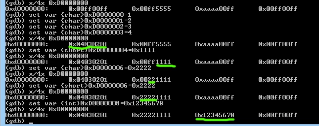

    The next screen shoot demonstrates direct data write to the SDRAM (not using DMA2D), as you can see everything works finely. Of cause it is not the real memory test, but I run tests also and they indicated no problems:
    I would like to hear any thoughts, please!

    Sep 23, 2017 12:53 PM UTC
    Posted on September 23, 2017 at 14:53
    Ladies and Gentlemen, I apologies - the second problem was related to hardware failure here (one of the lines between SDRAM and MCU was broken because of PCB defect).
    So:
    1. The first problem is there, but the solution works.
    2. DMA2D works correctly with the external SDRAM
    3. Address lines of the SDRAM can be swapped in the low byte (it is not a general rule, in general you should route pin-to-pin A0-A2 lines, but with current STM32 you can swap all lines in the low byte because of FMC does not issue burst accesses to SDRAM).
    Thanks!
    Oleg
