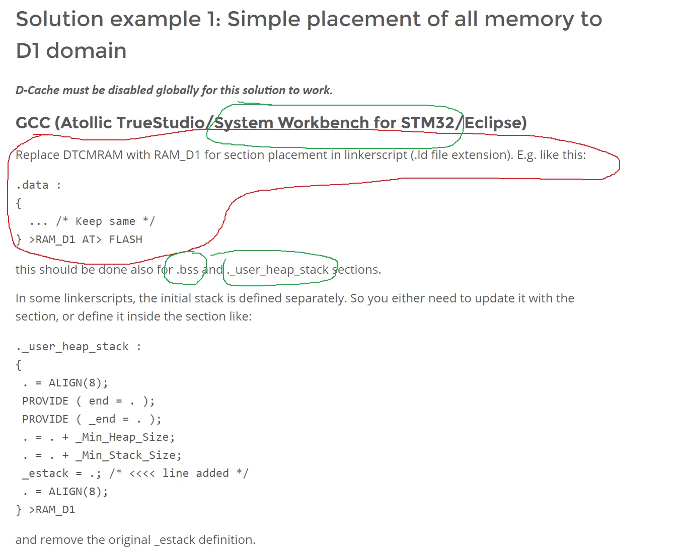

I have attached my sample project with STM32H7
https://1drv.ms/u/s!AuUAN7PWAxFS8l9pJ-mzXLp1vpXc?e=oFnJSX
In short, The basic function HAL_SPI_Transmit(&hspi1, aTxBuffer, 2, 1) work fine but it took a long time.For that reason, I tried to use HAL_SPI_Transmit_DMA to improve the SPI speed (HAL took so long time !!) like the function below
HAL_SPI_Transmit_DMA(&hspi1, aTxBuffer, 1);
while (HAL_SPI_GetState(&hspi1) != HAL_SPI_STATE_READY);
However, it looks like it is stuck at HAL_SPI_STATE_READY T.T -> always Busy ???
I don't know why the STM32H7 cannot work properly. I think that the DMA is not working well like this post: "https://community.st.com/s/article/FAQ-DMA-is-not-working-on-STM32H7-devices"
I try to apply "Solution example 1": Simple placement of all memory to the D1 domain. However, I don't know how to change the .ld file extension. It is so complicated for newbies like me when using STM32Cube IDE
Could anyone make SPI_DMA work with high speed in STM32H7. Thank you so much

Thank you for your reply,
In order to overcome the DMA issue, I select solution 1 which is considered to be the simple method.
0693W00000D03myQAB.pngFrom here there are some confusing things
In cased System Workbench for STM32 - STM32 IDE
quote "Replace DTCMRAM with RAM_D1 for section placement in linkerscript (.ld file extension). E.g. like this:
.data :
  ... /* Keep same */
} >RAM_D1 AT> FLASH
this should be done also for .bss and ._user_heap_stack sections."

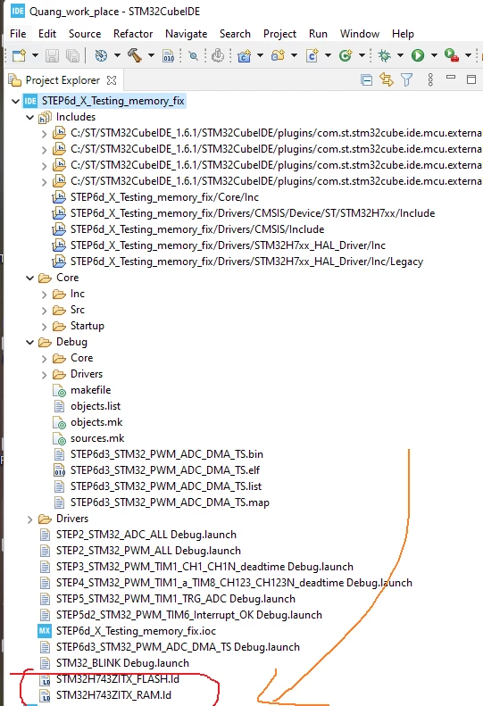

=>Question 1: there are two .id files one is flash one is Ram. -> I think that we need to change all (it depend on your programming method - store in FLASH OR RAM )
STM32H743ZITX_FLASH.id and STM32H743ZITX_RAM.ld

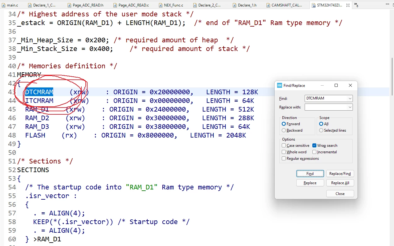

=>Question 2
"Replace DTCMRAM with RAM_D1 " is not clear. In my case, it is hard to know which one to modify ???
For example , does it mean ? we should replace " DTCMRAM  (xrw)  : ORIGIN = 0x20000000,  LENGTH = 128K" with " RAM_D1 (xrw)  : ORIGIN = 0x20000000,  LENGTH = 128K" ???

July 20, 2021
The FLASH linker script is used by default. You should just delete the other one to avoid confusion.
=>Question 2
Don't touch what you have circled here. Follow the previous picture for what to replace, you circled it in your previous picture.
Question 3:
Delete the RAM linker script.
Question 4:
Yes.
Question 5:
Yes

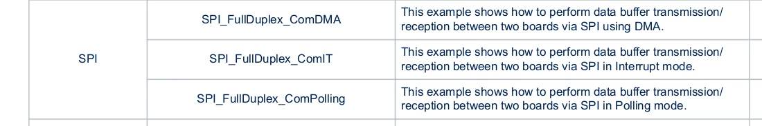

There are many examples for H7 SPI, just download stm32CubeMX.
https://www.st.com/en/embedded-software/stm32cubeh7.html
AP Note:
AN5033
Application note
STM32Cube MCU Package examples for STM32H7 Series
See:
DPham.2
DPham.2Author
July 24, 2021
Dear MasterT,
Thank you for your suggestion
the main issue is The Hal speed is so slow even with the DMA
After checking the example, I think the SPI Low level may help, I will read it.
