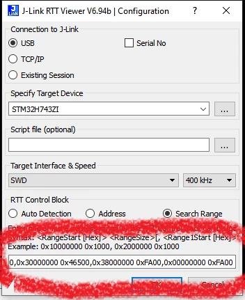

Hi there.
I'm sorry to update this thread, but I'm actually facing the same issue. (i.e. trying to get RTT output from H743 to PC).
I understand RTT is about Segger, but still ST talks about a TraceAlyzer compatiblity... which uses RTT.. mainly.
So far, I applied the SWD_Init (thanks for this!), but now facing the same issue XZ faced.
Regards.
alc6
Visitor II
October 31, 2018
Just a small update as I found the answer.
So why it was not working: my JLink settings made that he had no clue where the RTT Control Block was.
Locate it through this command in a terminal, being in Release or Debug folder that is present in your project's folder
cat *.map | grep _SEGGER_RTT
Obviously the RTT Block is somewhere after 0x20000000 in most case with this MCU, as my Jlink was trying to find it by itself, the range was not properly set.
So you have to specify that range, I found the answer in J Link user manual (08001) about how to specify that.
As I'm using Eclipse / SW4STM32 / J-LINK plugin, I followed these steps to apply the command string.
Right click on the project,
Debug properties,
Go into the Debug profile you are using (a JLINK one)
Startup Panel,
In Run/Restart commands: enter this: monitor exec SetRTTSearchRanges 0x20000000 0x10000
Now everything properly works on my H743ZI. I have an RTT output when using JLinkRTTClient .
Regards
AŁost.1
Visitor II
January 28, 2021
The solution is simple, define all RAM regions: 0x20000000 0x1F400,0x24000000 0x7D000,0x30000000 0x46500,0x38000000 0xFA00,0x00000000 0xFA00 in RTT_Viewer0693W000007D4w8QAC.png
