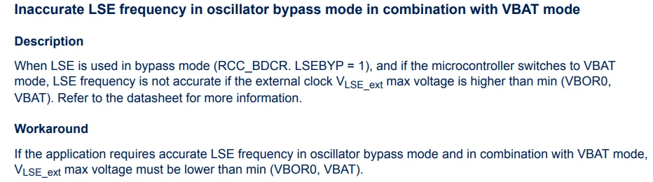

AAlis.23
AAlis.23Author
March 25, 2025
Finally I've found it on errata sheet:
I think this is the problem... more than inaccurate this wont start.
March 28, 2025
I don't think that errata covers it. They would say "doesn't start" rather than just inaccurate. Maybe you're right though. Maybe the inaccuracy prevents LSERDY from being set. Errata note could be more clear if this was the case.
You could open a support ticket if you wanted. Not sure what response you'll get.
I don't have a board with that package to test this.
https://ols.st.com/s/
