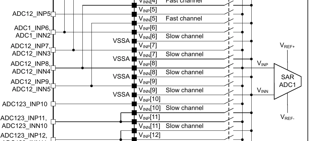

My device uses an STM32H743VITx MCU.
I need to use ADC3 at the beginning of my program to verify that three voltages are indeed at the correct values. Then I want to disable it completely before initializing ADC1 and ADC2 to avoid pin conflicts.
Does the function HAL_ADC_DeInit(&hadc3) allow me to do this?

No need to de-init the ADC3 , just dont start it / use it , if you dont need it later in your program.
There is no pin conflict between ADCs on same pin, otherwise Cube would not allow to set it, more than one ADC on same pin.
Any ADC just switching its sampling input cap to the selected input while its in the sampling interval at the beginning of a conversion; so as long as you dont start a conversion for pin XX , its not connecting the pin and cannot disturb any other analog function on this pin.
Just look at rm :
The analog mux is always there, just on a started conversion the selected input is switched to the ADC for the sampling time, then its disconnected again.

AScha.3Best answer
Aug 6, 2026 3:35 PM UTC
Just look at rm :
