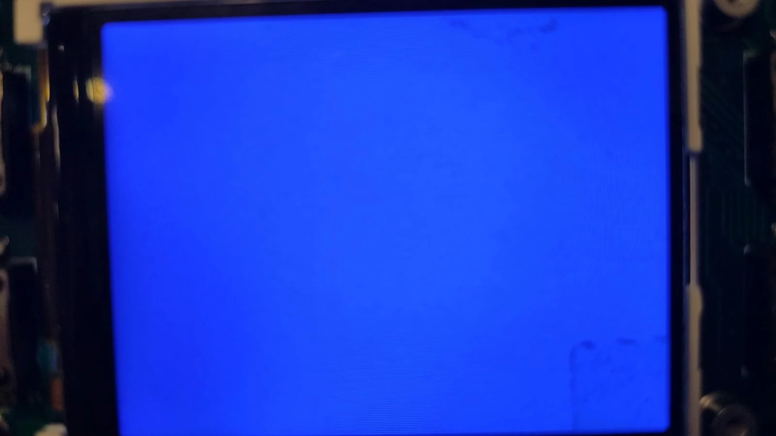

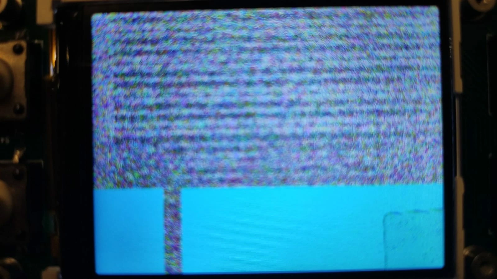

STM32H743 FMC with ST7789 doesn't work without delay
I have an STM32H743 connected to a screen that uses ST7789 via FMC (i.e. parallel connection) using 8-bit bandwidth and A18 to select between command and data.
The current code has an issue that the screen output is messed up (see pictures below) if I don't add a sleep to my write functions that uses FMC.
The code is working (no need for delay) under STM32CubeIDE but I ported it to work as part of MicroPython.
Things that I already considered:
  1. Python speed - The code in C is a nested for loop and calls writeData so it isn't a python speed thing.
  2. System clock/FMC - I copied the whole code of FMC initialization (including Msp), GPIO and systemclock to MicroPYthon without any fix.
  3. HAL version - MicroPython uses a different stm32 HAL version but I copied the SRAM/FMC files and it still didn't work
Any pointer on what might be the issue? Is it a FMC clock configuration? some configuration on external memory location?
Any config that slows down the FMC as RAM access

Filling the screen with the color blue without the delay in writeData produces:
With the delay (after a while since it takes 1ms per pixel) fills it correctly:

Feb 13, 2021 4:20 PM UTC
Found the issue, it was a missing volatile on the pointers to the FMC memory or as in STM32HAL syntax __IO - the code should be:
static __IO uint8_t* fmc_command_pointer = (__IO uint8_t*) COMMAND_LOCATION;
static __IO uint8_t* fmc_data_pointer = (__IO uint8_t*) DATA_LOCATION;
Now why this works in my STM32CubeIDE is a mystery, probably a gcc compile flag
