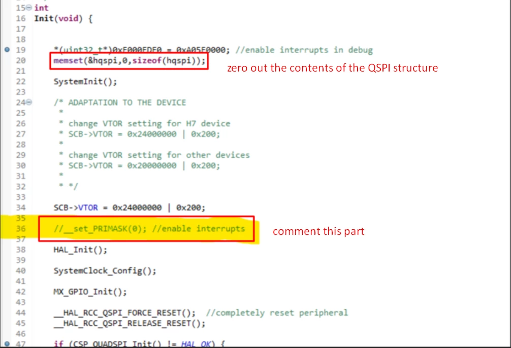

Found a resolution for this issue...
Apparently the enabling interrupts in the Init() function of the Loader_Src.c provided in the ST repository for the H7 external loader was hanging after it entered this function the first time.  Made the modifications below per ST suggestion...

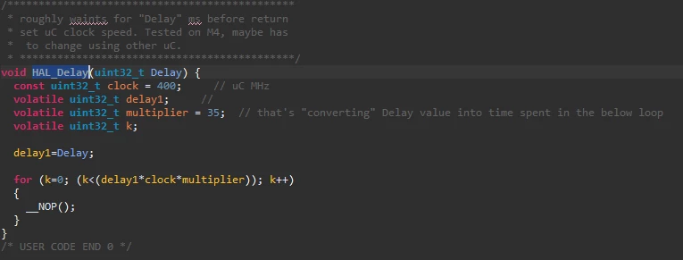

Once this was done however the HAL_Delay() in my QuadSPI drivers would hang (made sense since interrupts are disabled I guess) so I also had to include a local HAL_Delay() function that used NOP instead of ticks.
I added this in my quadspi.c file...
ST support is still looking into whey the enabling of interrupts is hanging in this case.

They need to move to a model that doesn't use interrupts.
If the board is running at 64 MHz, you can enable TIM2 / TIM5, with PSC=64000-1, ARR=0xFFFFFFFF, and you can pull the millisecond count from TIM->CNT
Using HAL_Delay() will make things slow. The HAL_GetTick() should be used to provide a bounding timeout, but functions should return as soon as the device is ready / finished.

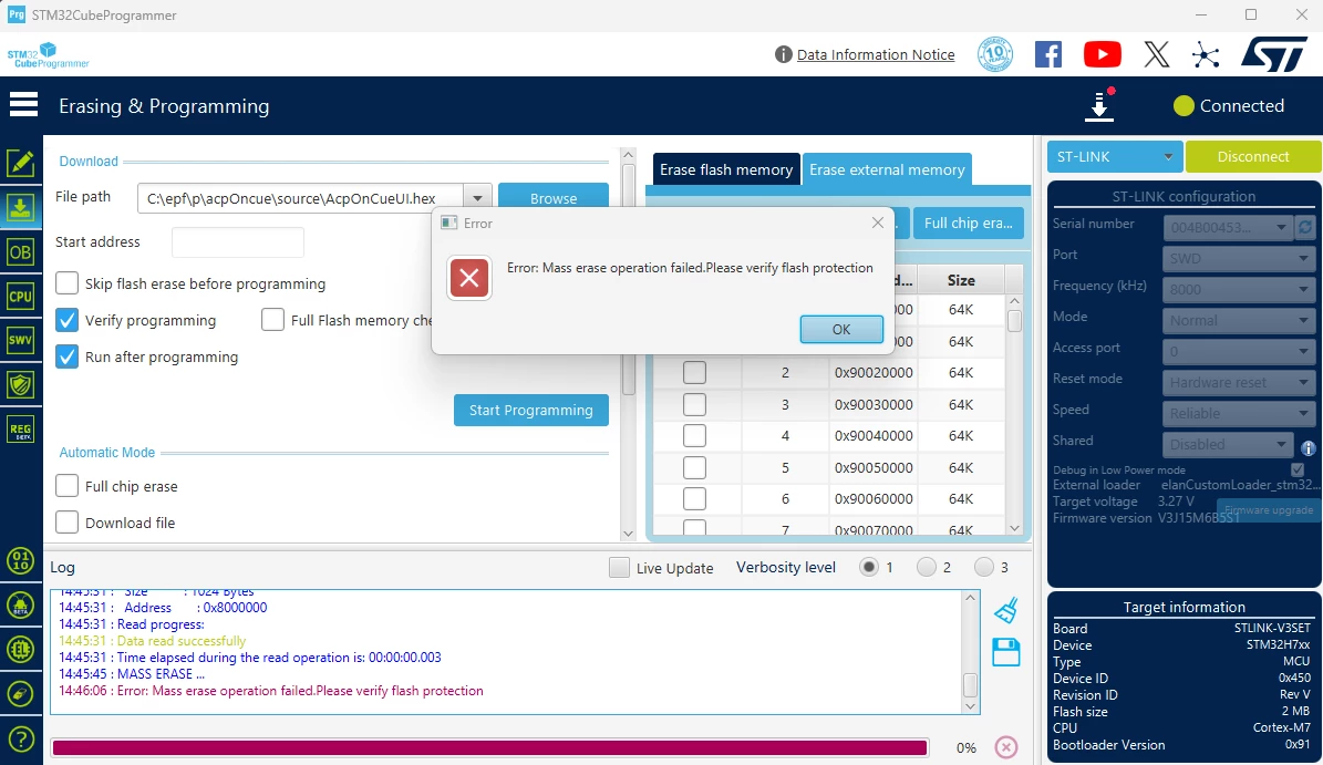

Tesla I have a mostly working external loader I developed for the Windbond W25Q64JV but for some reason the "Erase Chip" function for the external flash fails with the STM32Programmer as seen below...
This function works fine with the loader you provided for me (CLIVEONE-W25Q64_STM32H7XX-PB2-PB6-PD11-PF9-PE2-PA1.stldr) back in May 2023.  Could you share your W25Q64 driver code with me so I can see what is wrong with mine?

Initially I was using TIM6 for the timebase (based on application using FreeRTOS that cannot use SysTick) but the NVIC priority was set to 15.  I'm not sure if the priority was the problem or some timeout with the Loader_Src.c Init() function, but the ST Support solution to comment out __set_PRIMASK(0); that enabled interrupts just masked the issue and since the interrupts were no longer running the HAL_GetTick() never incremented so timeout values made no difference and I had HAL_Delay() overridden to use a loop of NOP.
By using SysTick for the Timebase and setting it's NVIC priority to 0 instead of 15 (default) I was able to use enable interrupts in Init() and use the standard HAL_Delay() and HAL_GetTick() just fine and almost everything worked just fine.  However, the Chip Erase still failed....Tesla was correct that this was a timeout issue.  Basically, I had a timeout value of 20000 (HAL_QSPI_TIMEOUT_DEFAULT_VALUE) I was using for most the QSPI functions.  I started using a larger value for erasing the chip, but I was using this larger timeout for issuing the erase chip command when in fact the HAL_QSPI_AutoPolling() is what needed the larger timeout value since that is what is waiting for the erase to complete.  Once I modified my AutoPolling function to use a larger timeout when doing a chip erase then that method started working as well.   Just multiple misunderstanding of how this loader works on my part on multiple fronts.
