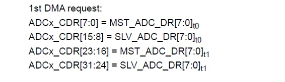

With the above config - I get the ADC Channel 3 data in CDR register bits [0..15] and ADC Channel 4 in CDR [15..32] - as expected.
I can scale it down to 8 bits, but if I can get down to 8 bit resolution it would be ideal -
Per  RM0433 if I set DAMDF=0b11 (8 bit mode) I am supposed to get
And then the 1st DMA request would be generated.
However I never get the full word populated I only seem to get the lower 16 bits in CDR and the Slave channel appears to have junk.

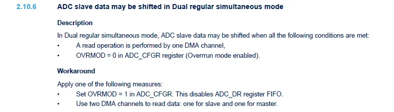

There is an ADC errata https://www.st.com/resource/en/errata_sheet/es0392-stm32h742xig-stm32h743xig-stm32h750xb-stm32h753xi-device-errata-stmicroelectronics.pdf
That seems to mention
 It seems sort of related but the workaround did not fix anything.
