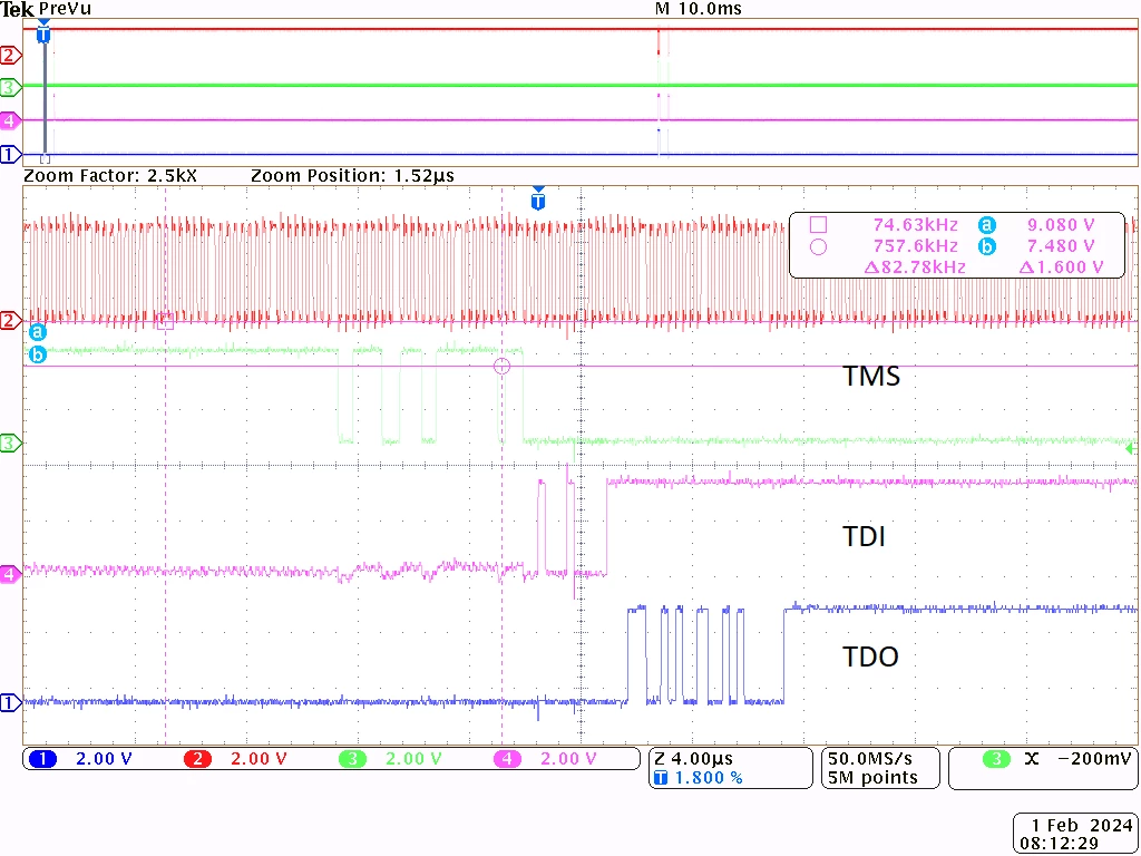

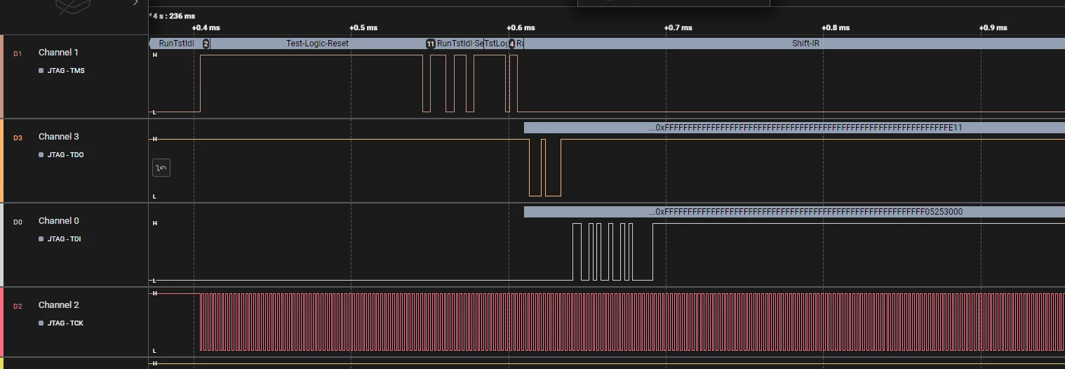

Hi everybody,
I'm trying to connect to the STM32H743IIT6 on my custom PCB via JTAG. It seems it responds, I traced it with a logic analyzer (attached). I'm not too knowledgeable with JTAG Protocol, but the 0x5253000 the H7 answers seems not to be the chip ID from the BSD file.
Consequently, I cannot connect via STProgrammer or CubeIDE.
I checked all VDD pins, they're all ok. BOOT0 pin is Ground, NRST is pulled high, VCAP pins are 1V. Pinning is correct.
I tried it with STLINKV3SET and a SEGGER J-Link base with the same results.
I also tried pulling NRST down before flashing with no result and I looked at the signals with an oscilloscope, they seem alright (attached).
Does anyone have an idea? I am out of ideas of what to try. Thanks a lot in advance!

Questions (based on experience to have my ST-LINK debug working on a custom STM32U5xx board):
  • what is the error message displayed by the debugger tool?
  • do you provide MCU VDD on debugger pin - so that debugger can "see" what the core voltage is?
    (very important to do - otherwise not correct signal level on debug signals)
  • do you have this "identification resistor" (for me 100R to GND on a debug header pin) - so that debugger can see it is connected to target board?
  • Are you trying as JTAG? Some MCUs, for my understanding, support only SWD (they cannot act and change mode on/from JTAG) - do you force SWD?
  • Try to lower the SWD frequency...
  • try options in debugger like "connect in low power mode", "connect under reset"
  • is the debugger connector (the pins) correct?
Another option to try is:
if you have USB connected - set BOOT to high and see if you can see the bootloader in STM32CubeProgrammer.
If all this fails: potentially the MCU itself is not properly powered.
What is the exact wiring of the DEBUG pins on your board (the debugger header connector and its signals)?

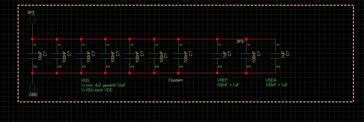

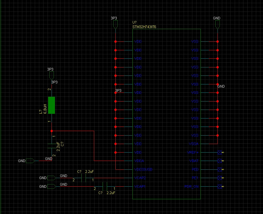

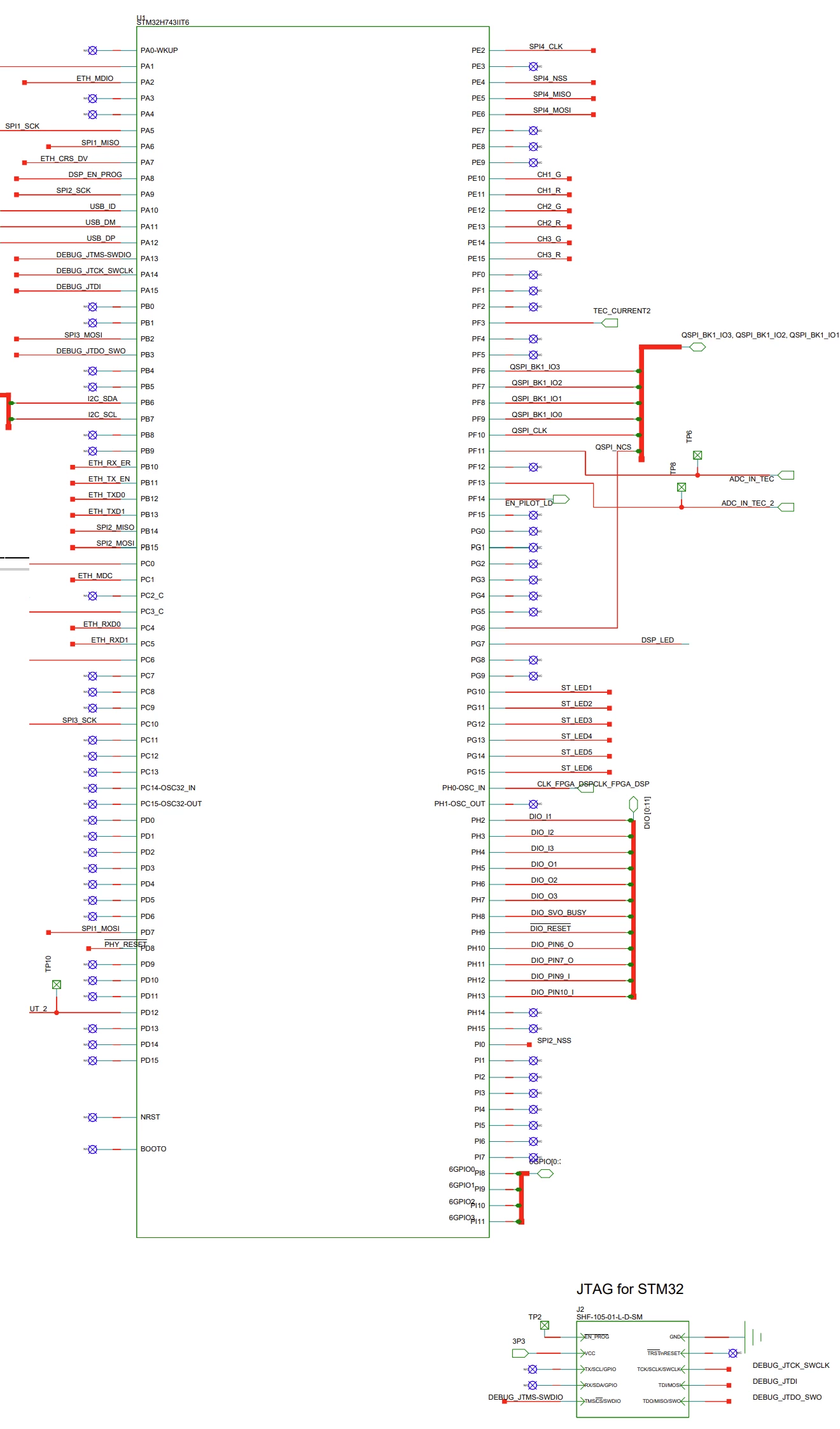

Present Schematic
Would expect VCAP voltage to be closer to 1.25V
LDO or SMPS mode?
mƎALLEm
February 1, 2024
No SMPS on H7 single core.

Zw_itAuthor
February 1, 2024
VCAP is at 1.08V
SMPS Supply with 32mVpp ripple. I attached the schematic snippets, because it would not be readable otherwise. The NRST and BOOT0 are NC in the schematic, I pulled up NRST with 10kOhm, and pulled BOOT0 down.

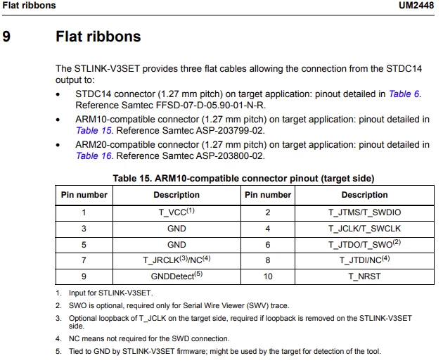

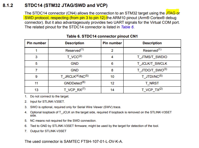

Hi everyone,
thanks for the many answers on short notice. Most things you mentioned I considered. Yet again, it was a small problem, which tjaekel post reminded me about.
We use a 10-pin jtag plug on our boards, which is different from the STLINK pinout. The first STLINK pinout you come across on the internet is also a 10-wire, so I build an adapter for it.
The problem is, the STLINK has a 14-pin on the debugger, where a 10-wire flat ribbon is put in the middle, meaning pins 1&2 and 13&14 are NC. I needed to change my adapter to that pinout and flashing with STLINKV3SET worked (see attached and UM2448).
This still doesnt answer why the segger j-link base does not work (pinning there is correct), or why the observed JTAG communication happens - but I can work with the STLINK, so that suffices.

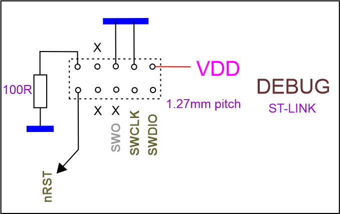

Lead II
February 2, 2024
Great, that at least ST-LINK works.
Correct, I had same confusion: NUCLEO boards populate a 2x5 debug header (1.25mm pitch) but ST-LINK adapter has 2x7 pins. I have to "center" the 2x7 ribbon cable as well.
The left and right pin columns are not used. One side is intended to connect the VCP UART to the ST-LINK (coming from a real UART Tx and Rx on MCU, ST-LINK provides these as VCP UART - I do not use).
Here my ST-LINK header.
I went with the same layout as on NUCLEO boards. And I have to "center" the 2x7 ribbon cable.
