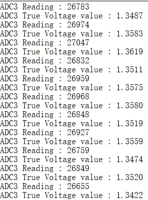

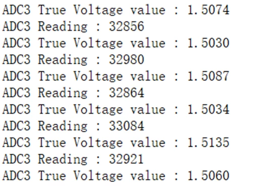

Now I want to use ADC3 to collect the voltage of single-ended signals. I used IN1 channel to collect the reference voltage source of 1.5V and the internal channel to collect the internal reference voltage source of the chip respectively. The test results are as follows。The code value returned and the corresponding voltage size are shown in the figure below。
It can be found that the error of code is relatively large, because the bits of ADC can not reach 16 bits or what other reasons? Please advise

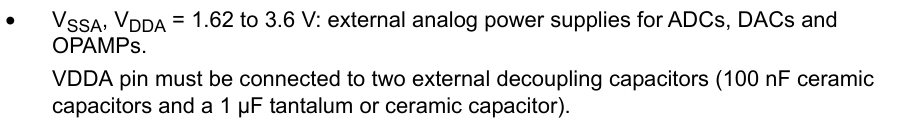

Small and branching ground traces are not ideal. The VDDA pin should have a larger capacitor near it to prevent voltage drops. The datasheet says 1 uF in addition to the 0.1 uF. That will certainly help, as would using a ferrite bead before the VDDA/VREF+ supply.
Lots of other tips in that application note.
You will never get the full 16 bits of precision with no noise, but you can get 12-14 or so, depending on settings.

Increase the sampling time to max for the best accuracy, and average many readings for even better accuracy for DC signals.
