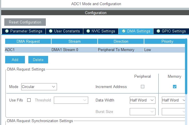

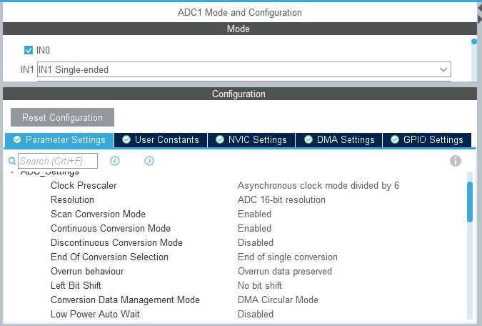

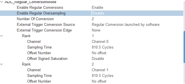

January 15, 2024
Query: Using STM32H743XI EVAL BOARD,
ERROR IN READING 2 ADC1 CHANNEL (PA0_C, PA1_C) IN DMA CIRCULAR MODE -
1ST CHANNEL GIVING ACCURATE COUNTS,
2ND CHANNEL SET AT 2V - ALWAYS SHOWING COUNTS SAME AS OF 1ST CHANNEL, WHERE POT IS CONNECTED?
ADC CLOCK, CONFIGS AND DMA SETTINGS AS FOLLOWS:
Tried example code also from STM32H7cubmx package (1.11.0), same result? anything missing from above configuration?
