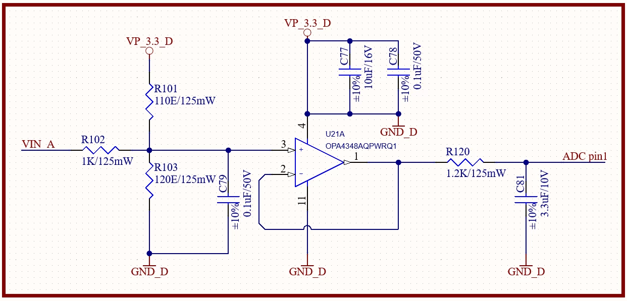

Made an opamp buffer after divider circuit using general purpose LM358, but still fluctuating. Will try with a precision opamp.

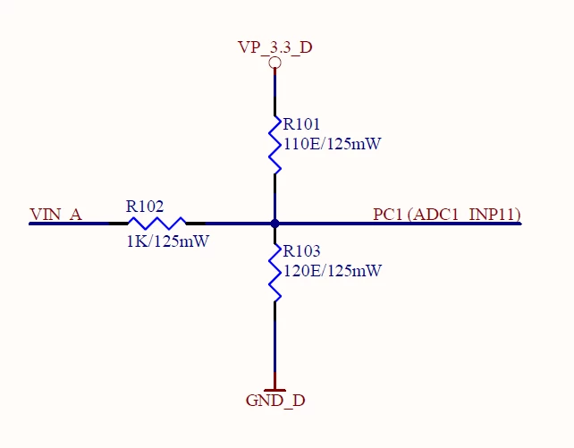

How about this divider circuit? Will also try a buffer after this.

The divider circuit is not the problem. If the voltage is stable its equivalent circuit is an ideal voltage source with a series resistance. It will be loaded by the ADC so the reading won't be correct, but it should not fluctuate. You already tried a buffer with a unity gain stable OPAMP and that didn't change the result.

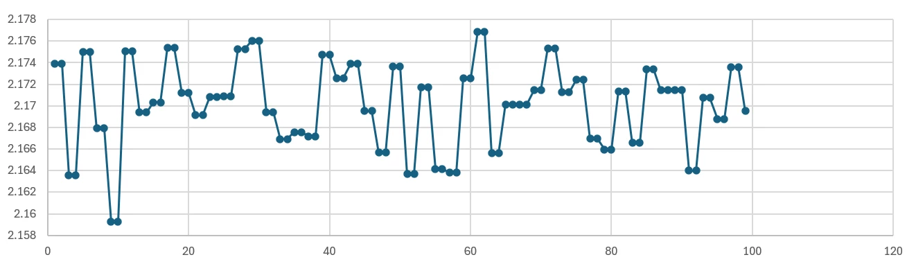

  • Multimeter reads a constant 2.172V output after the divider and buffer. Input to ADC is 2.172V.
This is the read ADC output count with voltage. This trend remains almost the same with or without the buffer.

I noticed a few things.
First off all I see a lot of duplicate values. Are you sure each data point is one sample or are you saving the values faster then they are sampled?
plot of countsplot of counts
The histogram (bin size 16 counts) doesn't look particularly like Gaussian (noise).
histogram of counts (bin size 16 counts)histogram of counts (bin size 16 counts)
Perhaps there aren't enough samples to conclude this. But in my experience you should see noise levels of 1 or maybe 2 counts. This spread of 350 counts is way too large!
FFT doesn't show any particular frequency stand out, but there are not enough samples to be sure of this.
