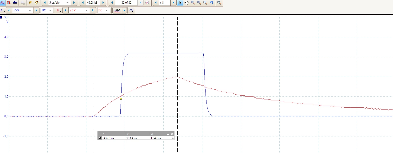

I have a problem with pins PC2_C and PC3_C on STM32H7. We have custom board based on this MCU and we want to interface SD card via SPI. We are using these pins: PA9 as SCK, PA0 as CS, PC2_C and PC3_C as MISO and MOSI respectively. I can not initialize the SD card to SPI mode and I think that the problem is caused by PC3_C pin. This MCU does not have PC2 and PC3 connected to external pads, so we must close the analog switch between PC2+PC2_C and PC3+PC3_C. This is done using SYSCFG_PMCR register. By my understanding, those switches are on this MCU closed by default, but I can close them either way using:
HAL_SYSCFG_AnalogSwitchConfig(SYSCFG_SWITCH_PC2, SYSCFG_SWITCH_PC2_CLOSE);
HAL_SYSCFG_AnalogSwitchConfig(SYSCFG_SWITCH_PC3, SYSCFG_SWITCH_PC3_CLOSE);

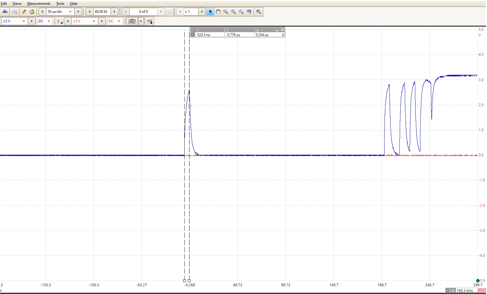

The switches close properly, as I can control those two pins manually. Now my problem is that on pin PC3_C - MOSI, the edges during SPI communication are so slow, that the SD card is not working.
0693W00000BdYQyQAN.pngI tried toggling the pins manually with pulse width around 1.4 us and curious thing is that while pin PC2_C is working well enough, PC3_C is so slow that its value does not even reach 3.3V, see picture:
0693W00000BdYBUQA3.pngYou can see that PC2_C (blue one) has rise time about 100 ns, PC3_C (red one) has more than 1.3 us.
I tried setting pin speed to Very High using the OSPEED register, but it did not help much.
According to datasheet page 68, those two pins have structure TT_A instead of FT_A, but i did not find anywhere what that means for the output frequency (only details I could find is Figure 77 in the RM). In the table 57 on datasheet page 161 (Output timing characteristics), there I could not find anything about those particular pins. According to this table, rise time of all pins in Very High speed is around 3 ns, which pin PC3_C exceeds by few orders of magnitude.
I found that minimum impedance of the analog switch for 3.3 V VDD is probably 315 Ω (datasheet page 163), but I do not know if it is of any help. Weird is that most people in other threads have problems with pin PC2_C and PC3_C is good, whereas I have it other way round.
So, am I missing something and is there any other way to change output speed of the pins, or there is just physical limitation that the edge cannot be faster than that? If it is the latter, I think it should be mentioned somewhere in the documentation (I could not find it).

Per our information directly from ST, this is a confirmed bug in sillicon and it will appear in an errata when they know exactly what causes the problem as they are not sure yet. They will fix the hardware only if they make new revision, which is not sure will happen.
