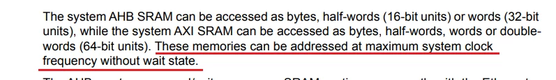

STM32H735IGK6 SRAM and Flash Speed
i am wondering why i can't find any information how fast the different SRAMs are.
For Flash you have to configure waitstates, to setup the speed according to the CLK, but not for SRAM.
I guess, because there is a dCache installed, the SRAM does not support full speed access or single cycle access.
So the question is, how fast is the SRAM?
best regards

From the RM0433:
