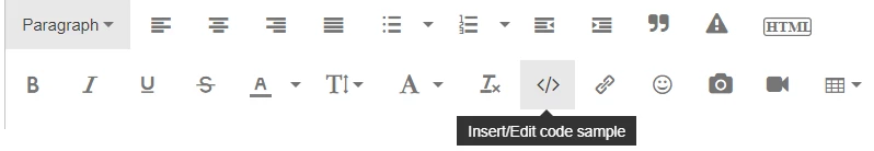

Next time, please use this feature to insert the code to enhance the readability of your code:
then:
Thank you.
