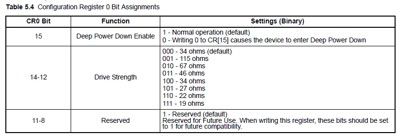

I haven't found a code to change HyperRAM configuration register on the STM32H735G-DK. Please provide it if it is available.
Thanks.

Hello @ASEHST ,
Thank you for your answer. I looked into the github folder but I still can't find the related code.
For example, if I want to change the drive strength of the HyperRAM, how can I do that?
