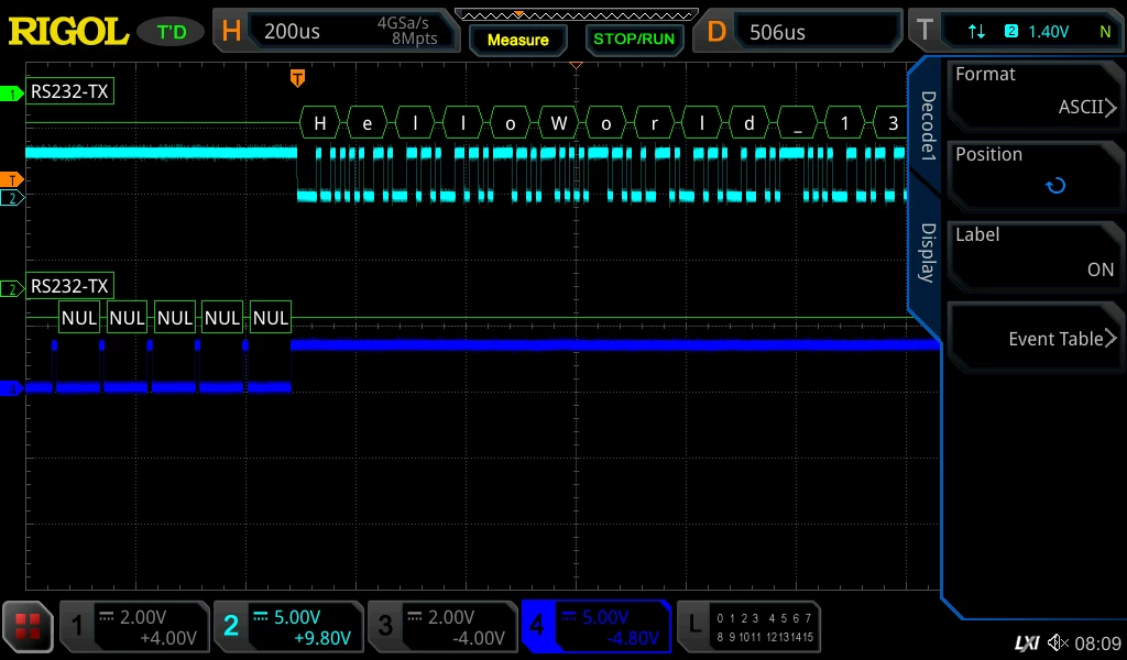

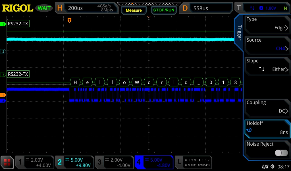

Hello Pavel, thanks for the answer. Attached some screen shots from the oscilloscope where I use a larger buffer and send the data roundrip from UART2 to UART9 and back from UART9 to UART2. There are no noises as I can see.
0693W00000SwDQ0QAN.png0693W00000SwDQ5QAN.pngThis is the receive buffer now with the first byte = 248d.
0693W00000SwDQFQA3.pngThis byte is only received with USART2 and not seen on HW. Could this also be a problem in the HAL?
Pavel A.
September 26, 2022
You show two TX lines (UART2 and 9?). Look at the RX line in the moment of enabling the UART.
