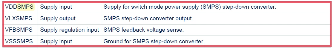

> No matter this config the VFBSMPS is connected correctly
What do you actually mean?
Is VFBSMPS connected or not?
Again, for SMPS I'm pretty sure it must be connected.
pin description:
February 21, 2025
Yes, VFBSMPS is connected as is VDDSMPS
