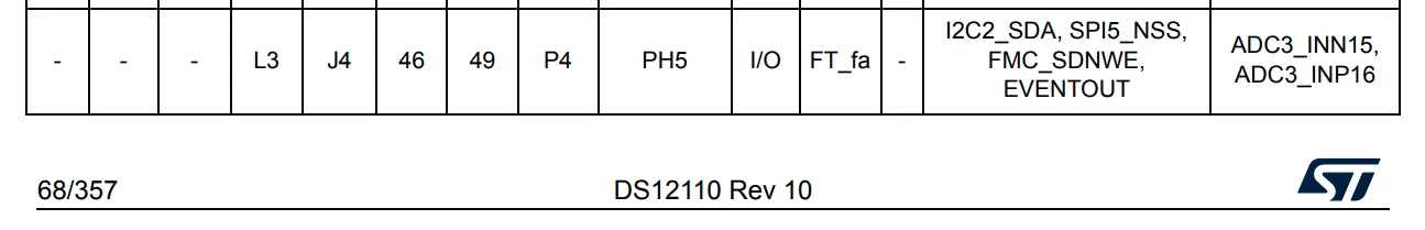

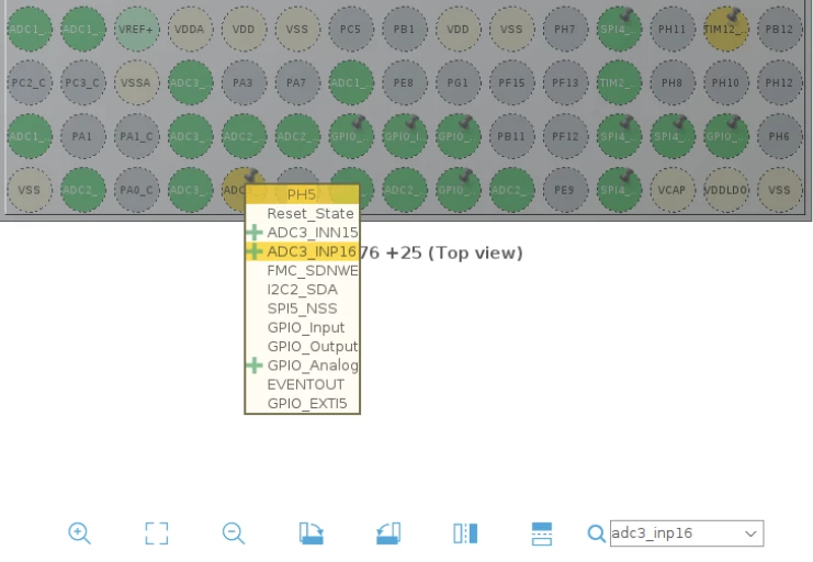

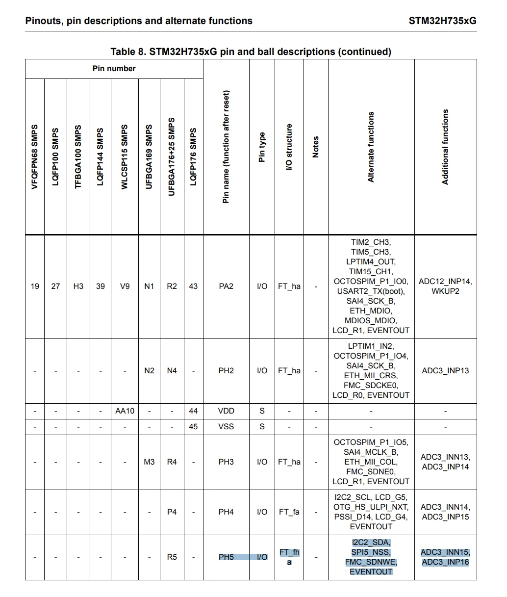

The data sheet for the STM32H735 (DS13312) lists "ADC3_INP16" as an additional function for PH5, and this function is also available for selection in both STM32Cube IDE and STM32CubeMX.

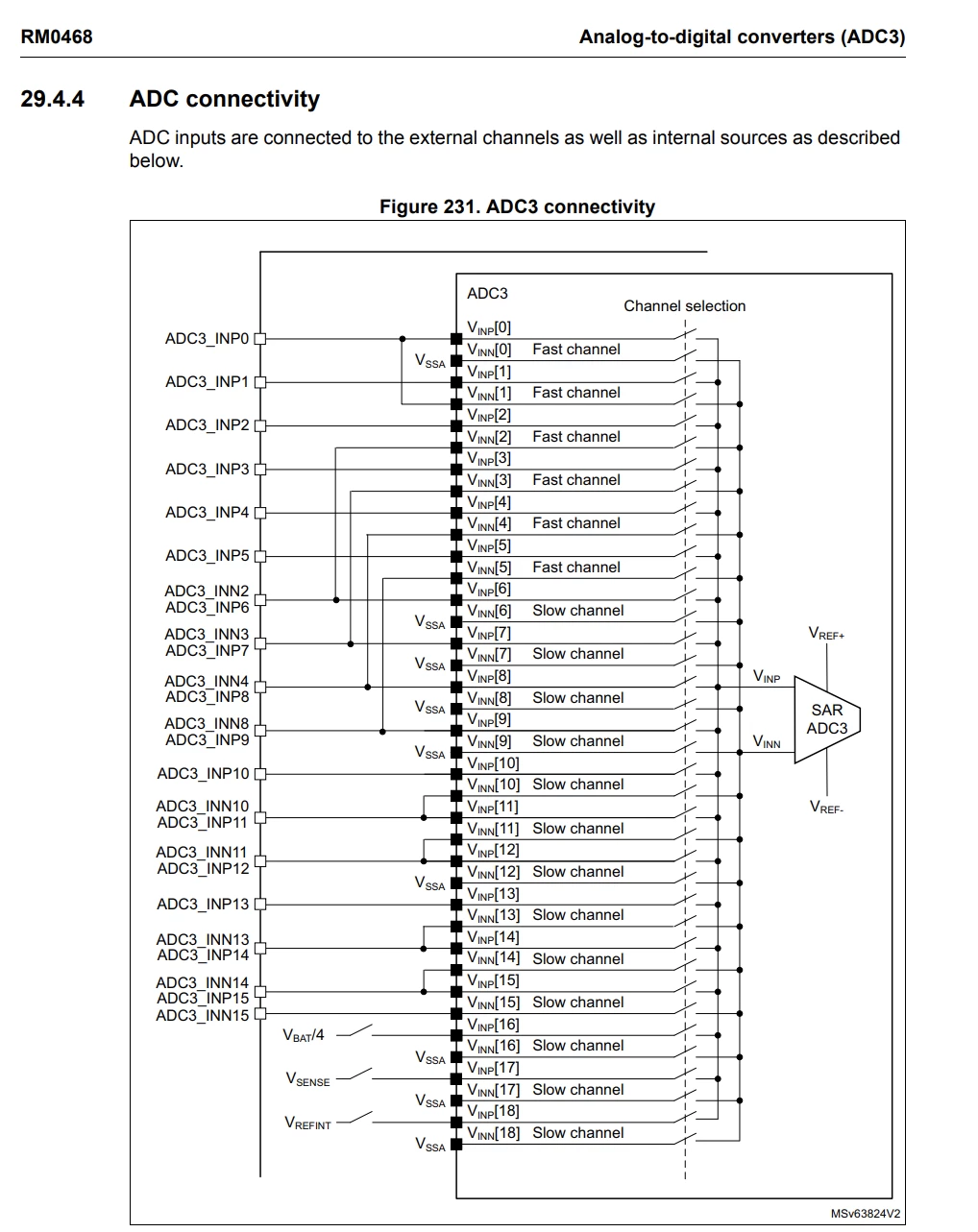

However, in looking at the STM32H735 reference manual (RM0468) , the ADC3 connectivity figure (29.4.4 Figure 231) does not list ADC3_INP16.
ADC3 has 19 total inputs (external inputs 0..15 and 3 internal inputs for vbat, vsense, and vrefinit),

I would bet it's a typo in the datasheet that the CubeMX programmers just followed.
It's also in the STM32H743 datasheet, but isn't selectable in CubeMX for that chip.

The ADC3_INP16 not connected to PH5.
The datasheet and the STM32CubeMX are wrong.
I reported this issue internally.
Internal ticket number for documentation update: 159618(This is an internal tracking number and is not accessible or usable by customers).
Internal ticket number for STM32CubeMX update: 159625(This is an internal tracking number and is not accessible or usable by customers).

Hello @dsurrett ,
The documentation issue is fixed in DS13312 Rev 4.
Edit: The STM32CubeMx is solved in STM32CubeMX 6.11.0.
