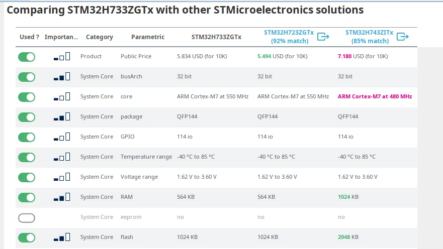

Heyho,
preparing the BOM for the next PCB version with the STM32H733ZGT (LQFP-144, 1024kB).
And finding that these are not available at our standard webshops. :-(
Started CubeMX to look for 100% pin compatible MCUs, and lo and behold: none found!
But I’m pretty sure that the following types are at least pin-compatible and mostly function-compatible (some only missing stuff like hardware encryption):
STM32H723ZGT, STM32H725ZGT, STM32H730ZGT, STM32H735ZGT
Am I correct, or are these not pin-compatible - maybe some internal LDO / SMPS stuff or some peripheral missing that I oversaw?

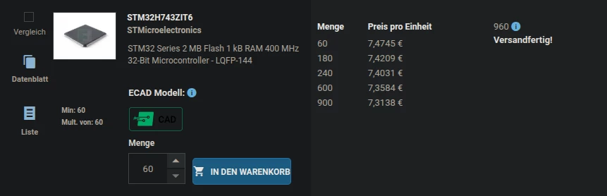

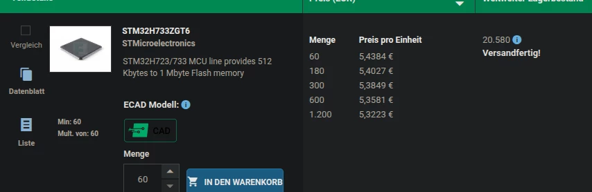

some are pin compatible…
we use (at work) H743ZI , H7A3ZI , H733Z , H723Z on same board ; just check SDMMC and ADC pin avail. , if want to use, because not all avail on same pins on all variants.
On my projects i prefer the H743Z .
see here at future electronics : H733ZG  , 20000 pcs avail, at about 6 € ; not enough for you ??
https://www.futureelectronics.com/search?text=stm32h733z&q=stm32h733z:searchRelevance:category:32-bit&selectedTab=products&selectedParentCategory=32-bit

Oct 14, 2026 3:53 PM UTC
STM32H723 is the same as STM32H733 minus the crypto features. If you’re not using those features, it is a drop in replacement.
The pin compatibility thing in CubeMX has always been flaky.

Thanks to all!
​@AScha.3 I usually check only Mouser & Digikey for prototype production (10 pcs), but as we will surely use soon a few more than the 60 future min. order, that will be okay. Thanks!
​@TDK just updated CubeMX, now I get at least some results. I thought this compatibility feature (and the basic clock & MCU setup) were the most useful features of MX.
