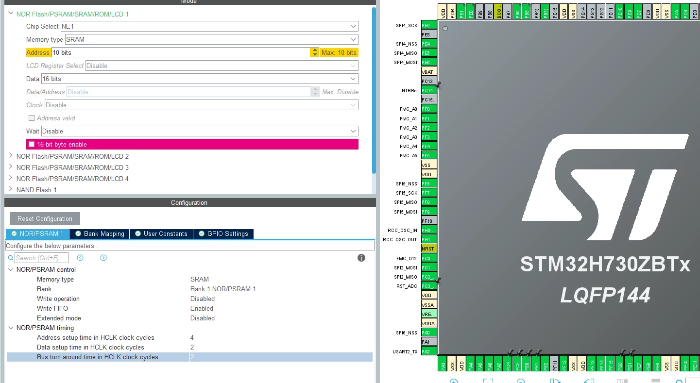

I have defined a FMC on STM32CubeMX as shown in picture 1.

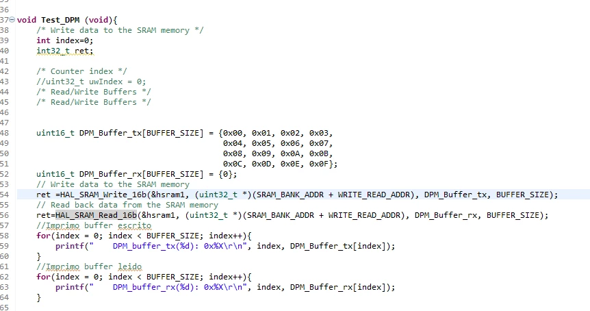

Then I have defined a function to test FMC. The function is: Test_DPM, shown in picture 2.
The other details needed:
#define SRAM_BANK_ADDR ((uint32_t)0x60000000) //Fig. 5, AN4891 Application Note
#define WRITE_READ_ADDR ((uint32_t)0x0800)

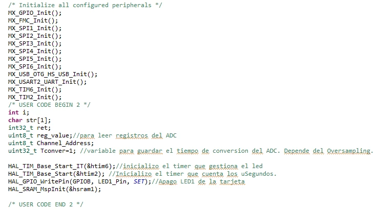

In picture 4 you have the initialization on main.c.
When I executed this, "HAL_SRAM_Write_16b" does not return enything and the application hangs.
I am writting to port B of Dual-Port - Memory, Renesas 70V24L15PFG
Any idea of what can be the problem?

Hello all,
I found out the problem. On SMT32CubeMX, there is an option which I had disabled. This options in "Write Operation". I enabled it and then it works.
Thank you anyway all for time.
