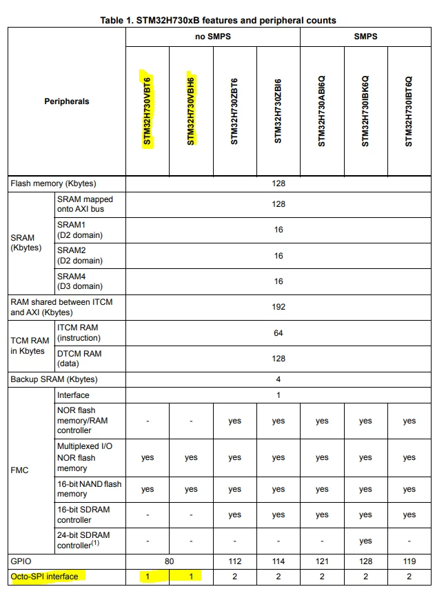

I cannot find any of the OCTOSPIM registers - neither in STM32CubeMX, nor in the register list, read by STM32CubeProgrammer. Am I right, that's because in our chip, there's only one OCTOSPIM port?
(I would appreciate, if that was mentioned in the reference manual, that that whole section "OCTOSPI I/O manager (OCTOSPIM)" has no relevance for certain chip subtypes, with a reference to the data sheet.)
But then I ask: Why do I still have the OCTOSPI2 registers? Because "In the default out-of-reset configuration, all the OCTOSPI1 and OCTOSPI2 signals are mapped, respectively, on Port 1 and on Port 2." (reference manual). And since I cannot change that mapping, and since I have no OCTOSPIM2 port, what's the point in the OCTOSPI2 registers then?

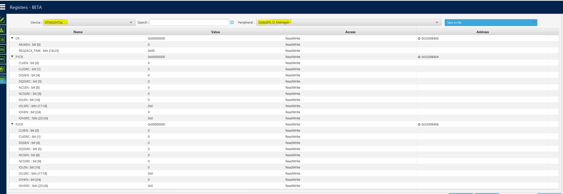

I made some tests with  STM32CubeProgrammer 2.14.0 and with STM32CubeIDE 1.14.0  and I can see the OCTOSPI I/O manager (OCTOSPIM) registers as shown in the below:
The registers view groups all registers supported in STM32H730 ( STM32H730AB STM32H730IB
STM32H730VB STM32H730ZB)
Note that STM32H730VBxx have one Octo-SP interface as mentioned in the datasheet.

I use STM32CubeProgrammer 2.16.0 and STM32CubeIDE 1.15.0.
Ok, I'm sorry, now I found it in the Programmer. I assumed (and wished) that the Peripheral list was alphabetically sorted, which it isn't, and further that a search for "octo" in the field left of it would show all "octo"-peripherals, which it doesn't.

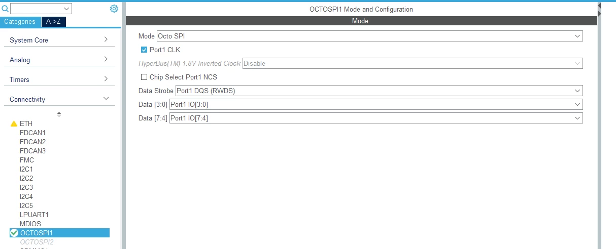

Still, I can't see it in the MX:
Where can I find your second picture "register view"?

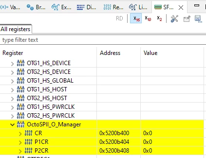

March 27, 2024
Ok, found it, it's while debugging inside STM32CubeIDE, on the right side.
Ok, there I also found the OCTOSPIM register.
Now, I understand, why I don't see it in the MX view: because the parameters I set in "OCTOSPIx Mode and Configuration" configures the OCTOSPIM registers "in the background". That's why these don't have an own entry there. It's a sub function of OCTOSPI, not a main function.
Can You confirm?

Yes, the second view is taken from the STM32CubeIDE tool.
The OCTOSPI I/O manager is not a peripheral, so you can not see the "OCTOSPIM" in STM32CubeMX "categories" but you can configure it as shown in the below figure:
And you can see this configuration in the generated code:
 sOspiManagerCfg.ClkPort = 1;
 sOspiManagerCfg.DQSPort = 1;
 sOspiManagerCfg.IOLowPort = HAL_OSPIM_IOPORT_1_LOW;
 sOspiManagerCfg.IOHighPort = HAL_OSPIM_IOPORT_1_HIGH;
 if (HAL_OSPIM_Config(&hospi1, &sOspiManagerCfg, HAL_OSPI_TIMEOUT_DEFAULT_VALUE) != HAL_OK)
 Error_Handler();
Thank you.
