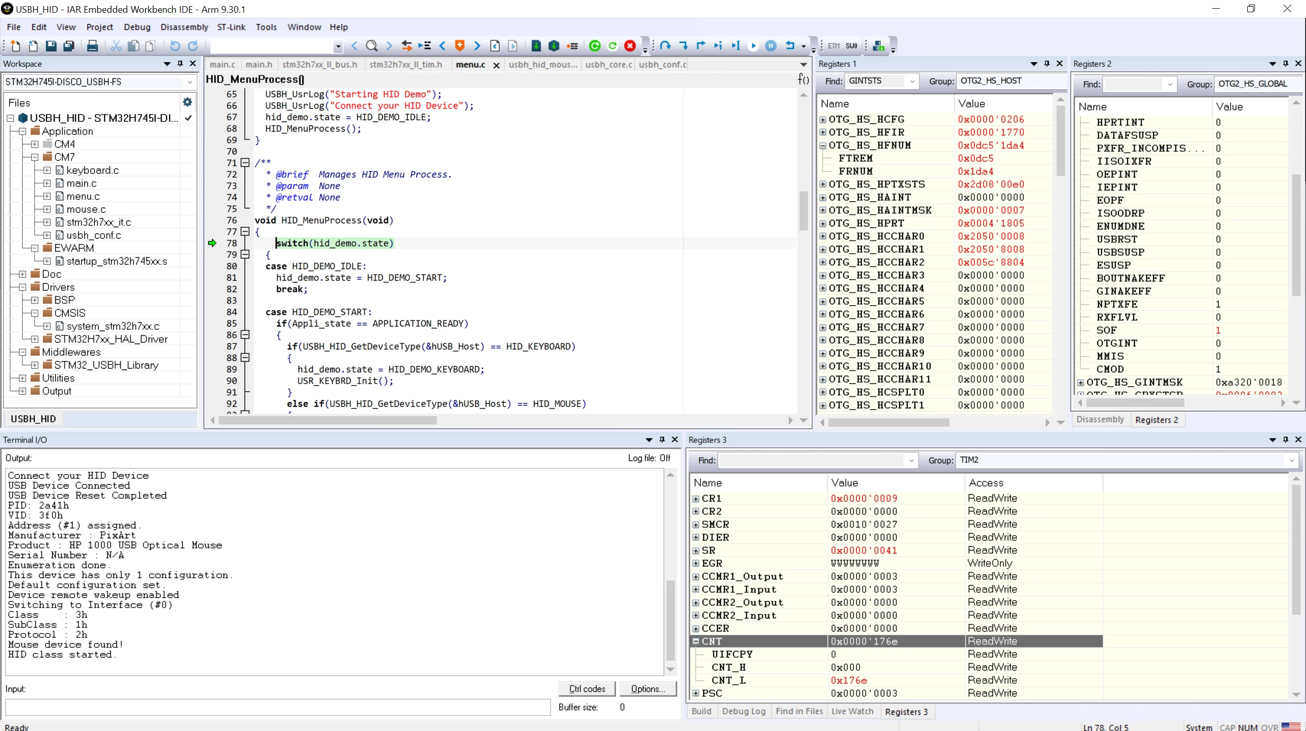

I had made a simple test on H745 disco board and I can see the timer counter is triggered as expected.

thanks for your testing!
But it is not what I want to do : I would like to have the timer count on PCLK clock as usual, and trigger the capture when the USB SOF event happens. So as to automatically timestamp the SOF instant.
