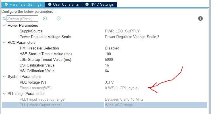

August 8, 2023
Hello again
It turns out the problem was with the FLASH latency. For some reason, the CubeMX set it to 0 instead of 1 (I'm working at 100MHz), also disabling the option on GUI:
Changing it on code, now the board is starting. Is it a CubeMX bug?

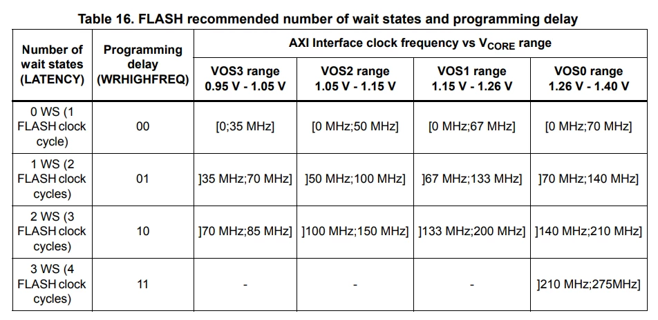

Hi @Peaga ,
The Number of wait states (LATENCY) depends from the AXI Interface clock frequency and VCORE range as shown in RM0468  table 16.
How much the frequency of AXI peripheral are you using in your clock configuration?
Note that, It mentioned in the datasheet (table12) that the maximum AXI clock frequency for VOS3 is 85 MHz.
Could please check the AXI clock frequency value?
Thank you.

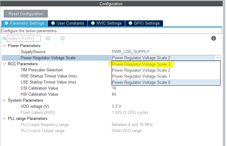

For STM32H730VBHx MCU and when the AXI clock is set to 100MHz, the STM32CubeMx 6.10.0 disactivates  "Power Regulator Voltage Scale 3" option as shown in the below figure:
Which STM32CubeMx version are you using? Could you please update the latest version of STM32CubeMx tool?

Why is VOS3 selected when VDD is 3.3V ? Is the supply voltage 3.3V indeed?
PeagaAuthor
Senior
March 7, 2024
That's a good question, I've thought that option was auto selected by Cube depending on clock configuration (and yes, VDD = 3v3). When I change the main clock to 400 MHz, for example, I can only select VOS0 or VOS1.
