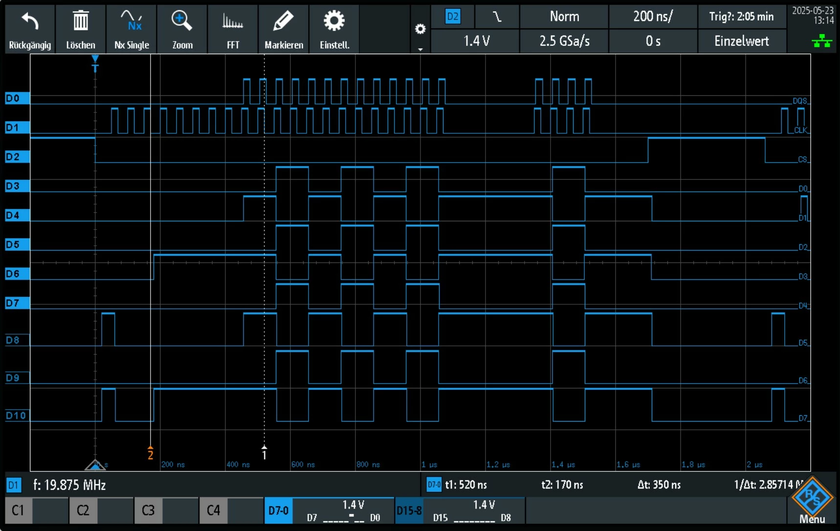

I have a custom board with a STM32H730 and an IS66WVH32M8 HyperRam.
The ram is connected on octospi1 outputs.
I can read and write in indirect mode to the internal registers of the ram.
But in memory mapped mode i read only wrong values.
To test the ram I write alternating 0x5555 5555 and 0xAAAA AAAA.
When I inspect in the memory view I see always the second byte wrong per word.
For example at address 0x7000 0000:
AAFFAAAA 55FF5555 AAFEAAAA 55DD5555
But when I measure the OCTOSPI on a scope, the data is correct (see attachement)
The setup of the OCTOSPI is as follows:
Clock speed of the OCTOSPI is 20Mhz with prescaler.
OCTOSPIM->PCR[0] = 0x07050333;
OCTOSPI2->CR &= ~OCTOSPI_CR_EN;
wait_busy();
OCTOSPI2->CR = 0x30000300;
OCTOSPI2->DCR1 = 0x4170700;
OCTOSPI2->DCR2 = 4;
OCTOSPI2->DCR3 = 0x5003F;
OCTOSPI2->DCR4 = 0xC8;
OCTOSPI2->TCR = 0x10000000;
OCTOSPI2->CCR = 0x2C003C00;
OCTOSPI2->WCCR = 0x2C003C00;
OCTOSPI2->HLCR = 0x010600;
wait_busy();
OCTOSPI2->CR |= OCTOSPI_CR_EN;When I run the almost identical setup on a STM32H735-DK, everything works as intended. Only the prescaler and OCTOSPIM are different.
How can I make the ram work on my custom board?
