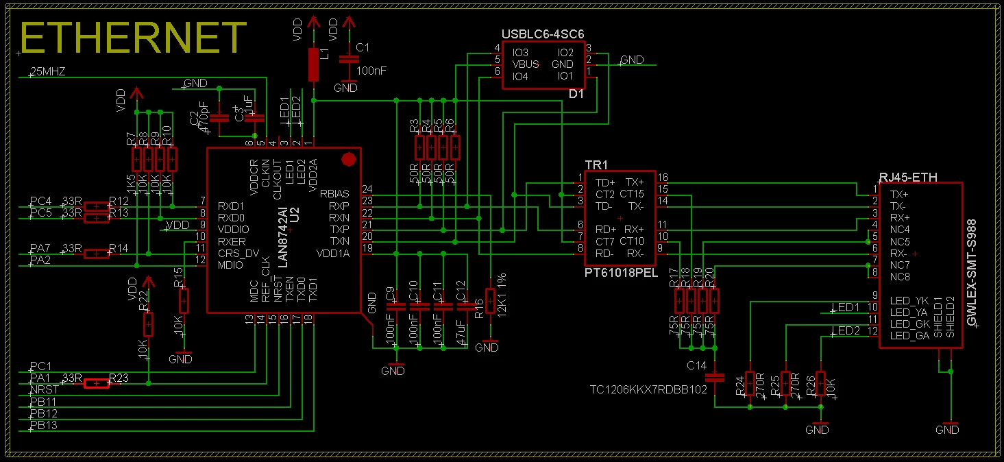

For the last couple of weeks I've been trying to deal with receiving an ETH frame from PHY on my own PCB design with STM32H730VBT.
To make sure the firmware is OK I took a Nucleo-H723ZI (CPU from the same family) and configured it to work with lwIP under CubeMX - Everything works fine. Frames are sent and received and DMA operation looks like on other STM32H7s.
Then I corrected the GPIO configuration to match my design:
PB11 -> RMII_MII_TX_EN (CS_TX)
PB12 -> RMII_MII_TXD0
The remaining pinout for RMII is identical to Nucleo.
The schematic is typical for the LAN8742A (sorry for circuit quality):
After startup, frames are transmitted but any receive data (multicast, unicast, etc.) is missing.

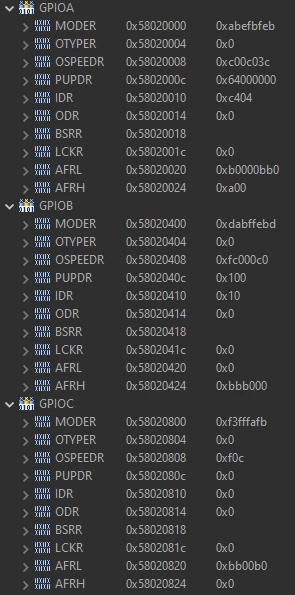

- GPIO and ETH register configuration: Since this is almost identical firmware to the Nucleo, the differences are only at GPIOB (TX_EN + TXD0). CPU_CLK=500Mhz (HSI+PLL). HSE disabled.

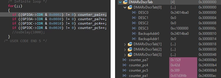

- CRS_DV, RXD0, RXD1 lines checked with oscilloscope at CPU itself - everything looks like on Nucleo. I added a simple routine to make sure the data is physically received by the CPU:
As you can see, high level states readings are appearing (according to whether a packet appears after ETH). If packets received by PHY do not appear then the counters do not increase.

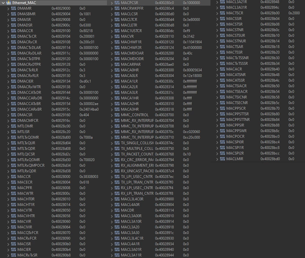

- After setting Loopback in ETH_MACCR.LM (bit 12), the firmware correctly receives the frames it sends - the buffers are filled correctly and the DMA works as it is written in DMARxDscrTab.

Lukasz_Klis
December 8, 2023
Hi LCE,
Thanks for your reply.
I am 100% sure of this GPIO configuration, because only pins PB11 (RMII_MII_TX_EN) and PB12 (RMII_MII_TXD0) are different but transmitting works OK.
I checked all RMII lines with an oscilloscope and compared with Nucleo - No differences. Even the latency and noise level was a similar.
I checked 3 different assemblies (copies) of this device. They all have the same problem. Rather, bad soldering can be ruled out (RXD low/high signals are visible in the GPIOC->IDR register).

I found it !!!
I don't know how I didn't catch it before, but PC4 was swapped with PC5 (RXD0 <-> RXD1).
The best part is that I thought the order was correct.
Problem solved.
