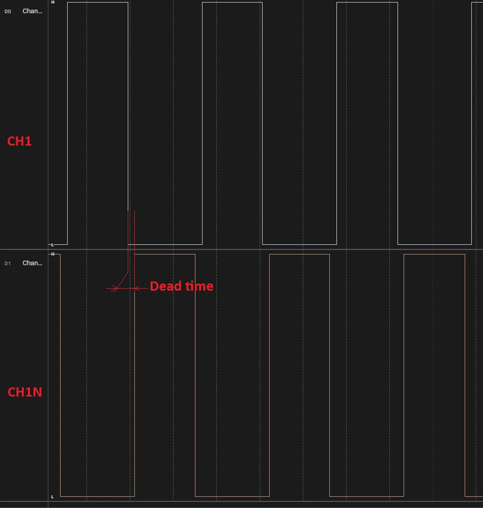

Hello ​@smal and sorry for the late reply,
In your case you need to use PWM output with complementary channel for example using CH1 and CH1N outputs by inserting a dead time and duty cycle set at 50%.
ALL OFF→ is the dead time insertion.
This is an example (inspired from NUCLEO-H743ZI\Examples\TIM\TIM_ComplementarySignals) of code to configure TIM1 to generate complementarity PWM signal outputs on CH1 (PE9) and CH1N (PE8):

What is needed from you is to define 3 parameters:
  • The frequency of the signal which is defined mainly by TimHandle.Init.Period based on the timer clock.
  • The duty cycle that should be set at 50% which is defined by sPWMConfig.Pulse.
  • The dead time: defined by sBreakConfig.DeadTime.
This is what you should get at CH1 and CH1N:
Each channel i.e. CH1 and CH1N will control respectively a couple of the MOSFETS (T1, T4) and (T2, T3).
Hope that helps.
