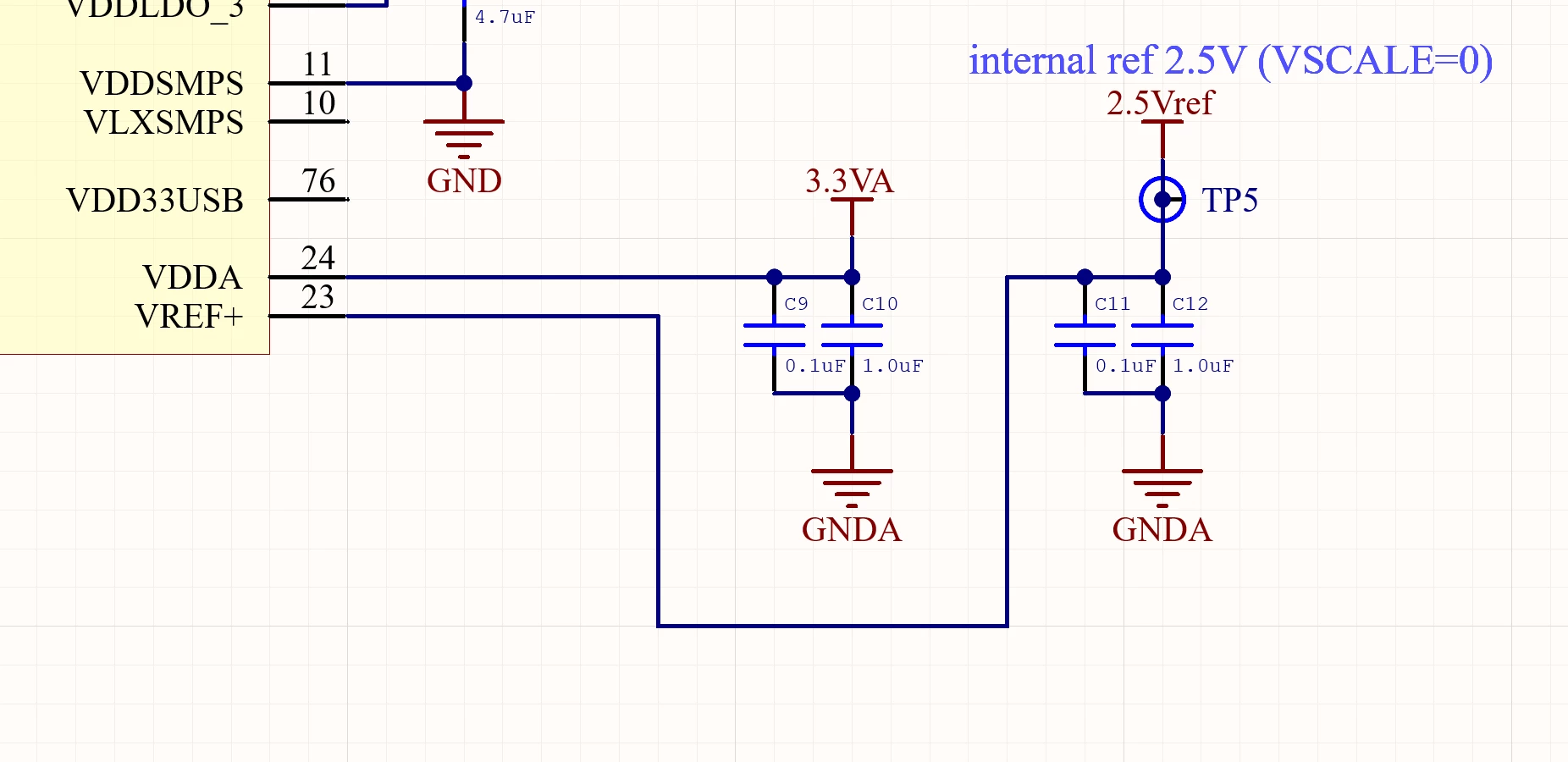

STM32H725VGT3TR Vref changes when I enable ADC1

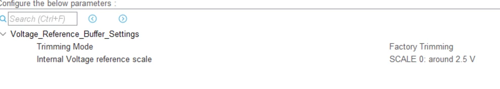

I have my internal Vref set to 2.5V (stage 0).
The value reads correct (2.52V) with a meter on the test point below until I call HAL_ADC_Start_DMA().   Once HAL_ADC_Start_DMA() -> ADC_Enable() -> LL_ADC_Enable() is called the voltage goes up to around 2.9V.
Any thoughts as to why this is happening?
Thanks!

Are you converting channels out of bounds? (above 2.5 V?)

No, I am currently trying to digitize a 1V DC test signal.
RallyTronics
Aug 5, 2025 9:18 PM UTC
Let me double check my unused channels.
RallyTronics
Aug 5, 2025 9:21 PM UTC
Looks like that's the problem.
