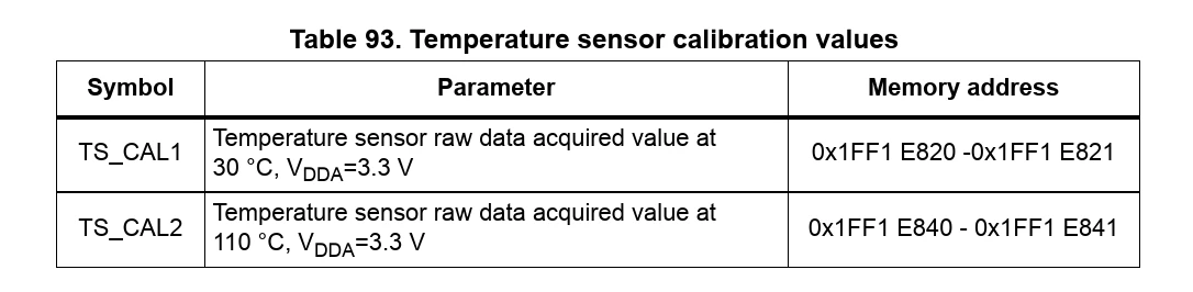

But on the analog sensor you have the stored calibration value for 110° :
So if you want to know the chip temp at high clock + dissipation, this should be the better (really tested on this chip) value, to check chip temperature at around this 110° .
