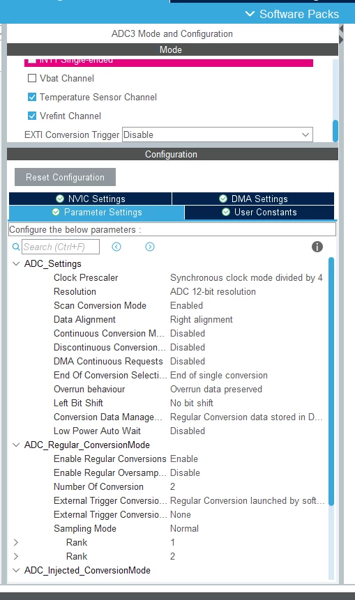

Hello, i am trying to read internal temperature and vref values from ADC3. I shared ADC3 ioc settings.
ADC clock mux freq is 96MHz and sampling time is set to ADC3_SAMPLETIME_247CYCLES_5.
On init routine calibration line as below :
HAL_ADCEx_Calibration_Start(&hadc3, ADC_CALIB_OFFSET_LINEARITY, ADC_SINGLE_ENDED);
When i am trying to read internal temperature with :
*result = __HAL_ADC_CALC_TEMPERATURE(TEMPSENSOR_CAL_VREFANALOG, adcResult, ADC_RESOLUTION_12B);
everthing is fine with roughly 44.5 degrees. But reading vref is not working properly.
*result = __HAL_ADC_CALC_VREFANALOG_VOLTAGE(adcResult,ADC_RESOLUTION_12B);
This code returns 206mV.
