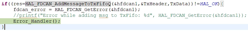

I am trying to send some CAN-bus messages from a STM32H723VGT6 mounted on a BIGTREETECH SKR 3 EZ V1.0
I am following this video to send standard CAN messages in external loopback mode (https://www.youtube.com/watch?v=kXyzaaSk6Qs&t=568s&ab_channel=ControllersTech). But whenever I reach the point where I add a message to the TxFifo I get the error 0x20 -> "Parameters error" but I am not sure what could be causing this

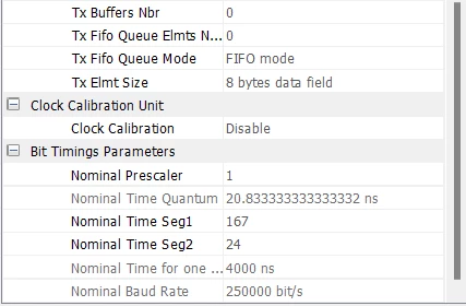

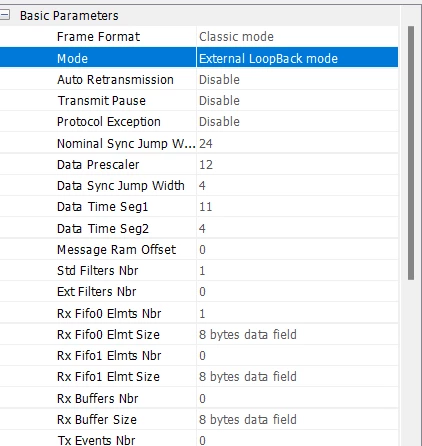

Here are the parameters I set for FDCAN1
To avoid additional variables we used the internal clock of the microprocessor, here is the final frequency of the FDcan peripheral

1- I don't see a reason to stop the FDCAN after Init:
 if(hfdcan1.State != HAL_FDCAN_STATE_READY){
	 HAL_FDCAN_Stop(&hfdcan1);

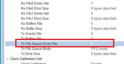

2- From stm32h7xx_hal_fdcan.c:
 if (hfdcan->State == HAL_FDCAN_STATE_BUSY)
 /* Check that the Tx FIFO/Queue has an allocated area into the RAM */
 if ((hfdcan->Instance->TXBC & FDCAN_TXBC_TFQS) == 0U)
 /* Update error code */
 hfdcan->ErrorCode |= HAL_FDCAN_ERROR_PARAM;
 return HAL_ERROR;
-> As you can see in the comment, you didn't allocate memory into RAM for Tx messages.
You removed the FDCAN Init from the main.c you shared but according to CubeMx Fifo elements number = 0:
You need to set it at least to 1.

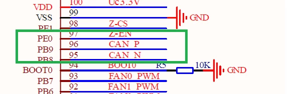

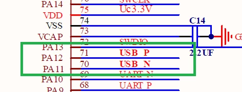

I attached the schematincs of the board. There is a mistake regarding the pins connected to the canbus peripheral. The correct pins are PA11 and PA12 like the default configuration of FDCAN1 from STCubeIde
I also attached the .ioc file and the main.c file as you requested
Right now we are just testing the board in external loopback mode, do we still need to have another node connected to the bus?
mƎALLEm
November 11, 2024
Thank you for the sharing.
According to the schematics, you need to use PB8/PB9 (connected to the tranceiver which is not necessary in LoopBack mode) instead of PA11/PA12 as the latter are used by USB and may external components force the IO levels of the MCU.
